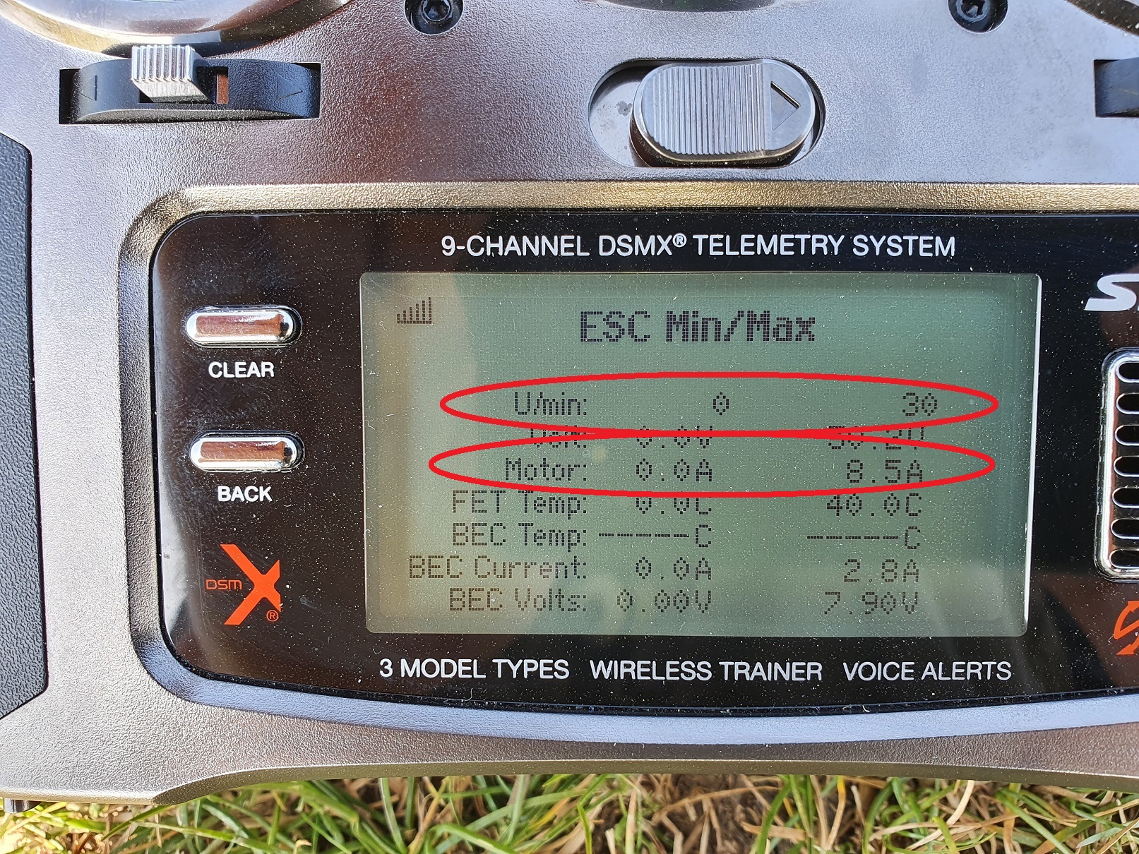

I have only one problem: I dont get the correct rpm value on my DX9. Maybe the max motor current is wrong as well on the MAX MIN page.

But the RPM Headspeed is wrong. It shows a value of 10, 20 or 30 on my radio. Thats it.

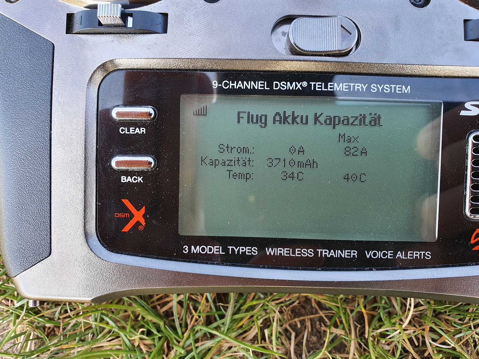

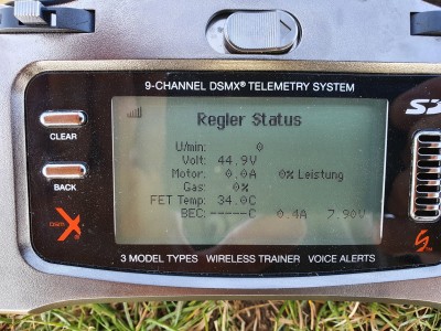

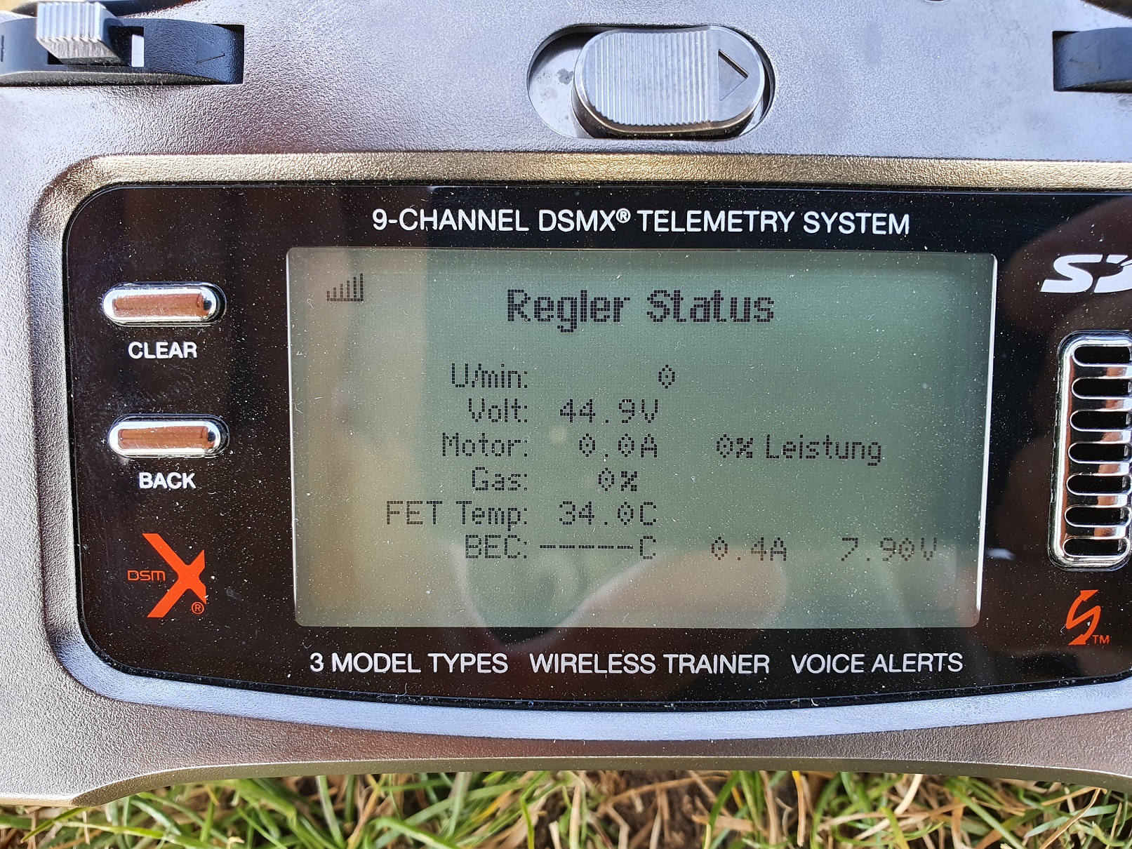

Attached some photos how it looks like on my dx9 screen:
Would be great if anyone can help me with that problem.

please leave default settings in the YGE and then set gear ratio in the unit.
Please note Gear Ratio in radio must be also at default.

I set the parameters in the YGE to default and added the gear ratio in the spirit software. That works fine.
