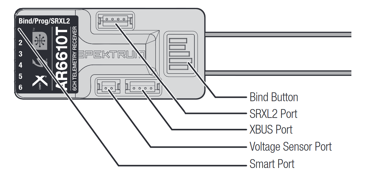

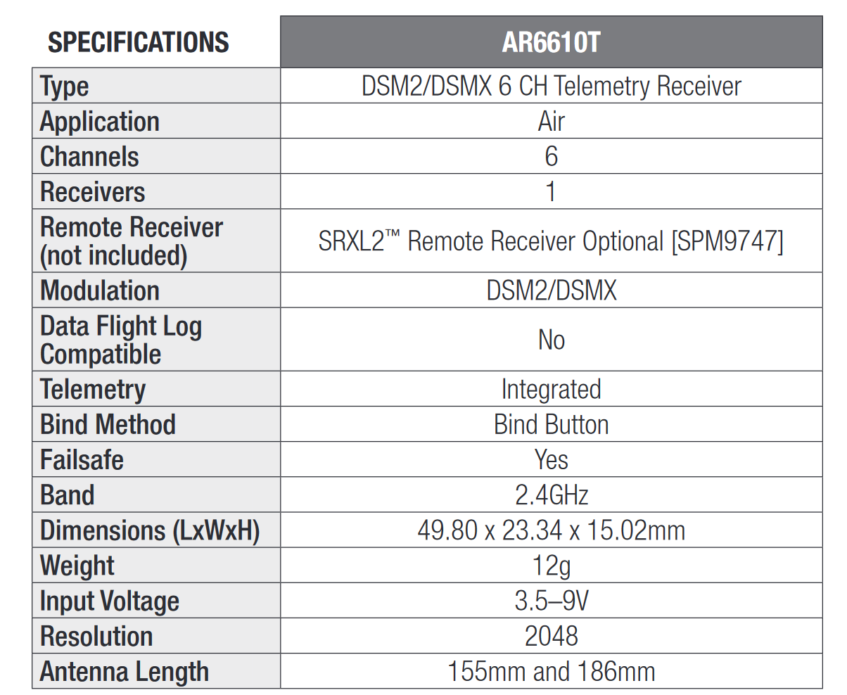

I've now done my research again, it's the case that you don't plug the normal satellite receiver (DSMX) into the AR6610T but you must just use one SLRX2 satellite! This means that you definitely have to buy an additional remote receiver with SLRX2 protocol, for example the SPM9747, then you can consider either plugging it into the SAT2 input of the Spirit or plugging it directly into the corresponding interface of the AR6610T -
Best regards
Here is a picture of the AR6610T with the description:

Here is the info about the remote receiver:

Just to add that if you go down the route of putting a 9747 sat into the SLRX2 port of the 6610 you will neet to put the lead that connects to the Spirit in
to the Smart socket not the SLRX2 output socket...
