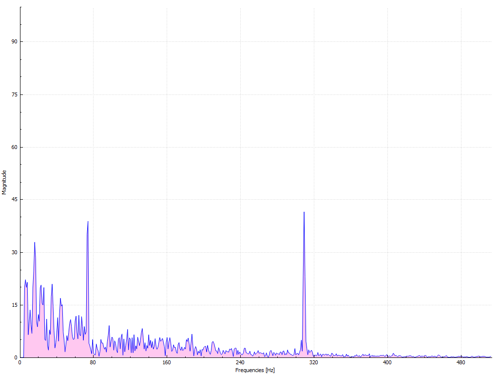

I did not check the vibration log. Apart from a bit of resonant vibration at about 3000 rpm, it seems to be alright.

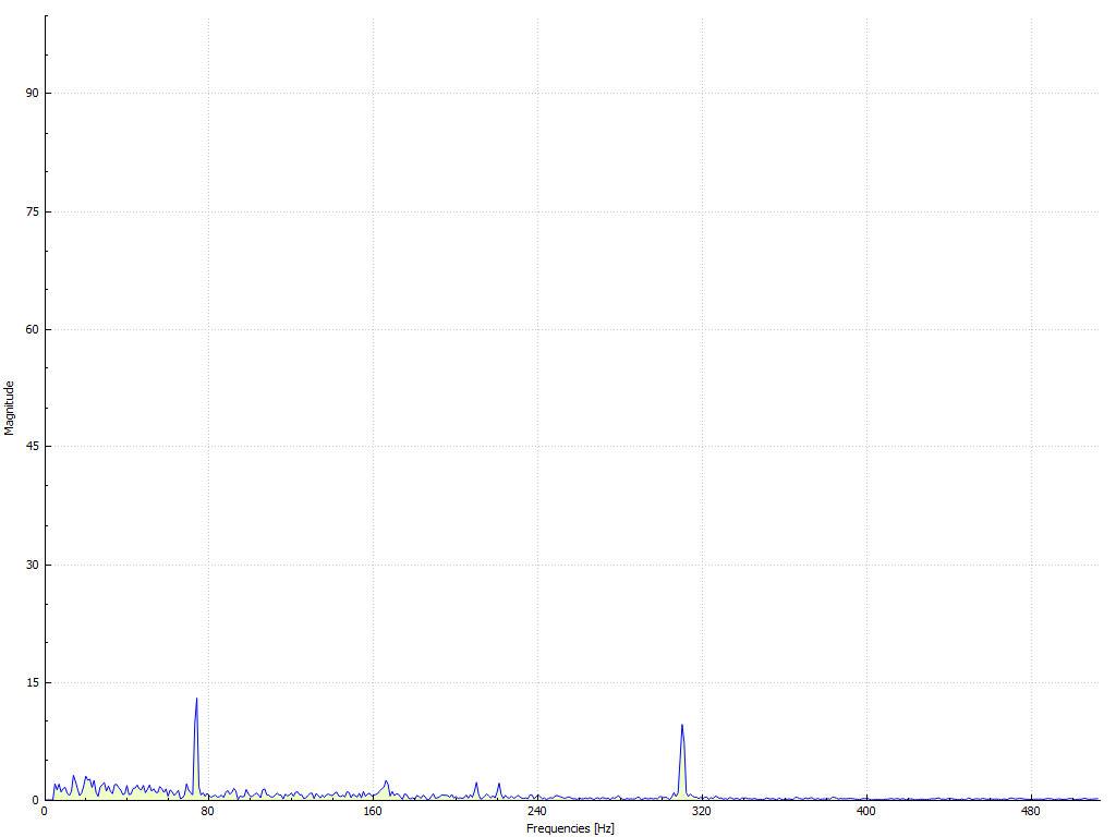

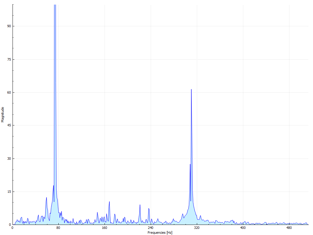

Now back home did a spectrum analysis. X and Z axes seemed to be fine. However, vibration in the Y-axis (aileron) was bad. If I disengaged the motor pinion from the main gear, there was totally no spike of vibration.
If elevator was fine but not the aileron, then I guess it cannot be the bearing block.
Which part should I test next?
I have been using default for 450 and have not changed the system values for tail delay and piro consistency.
