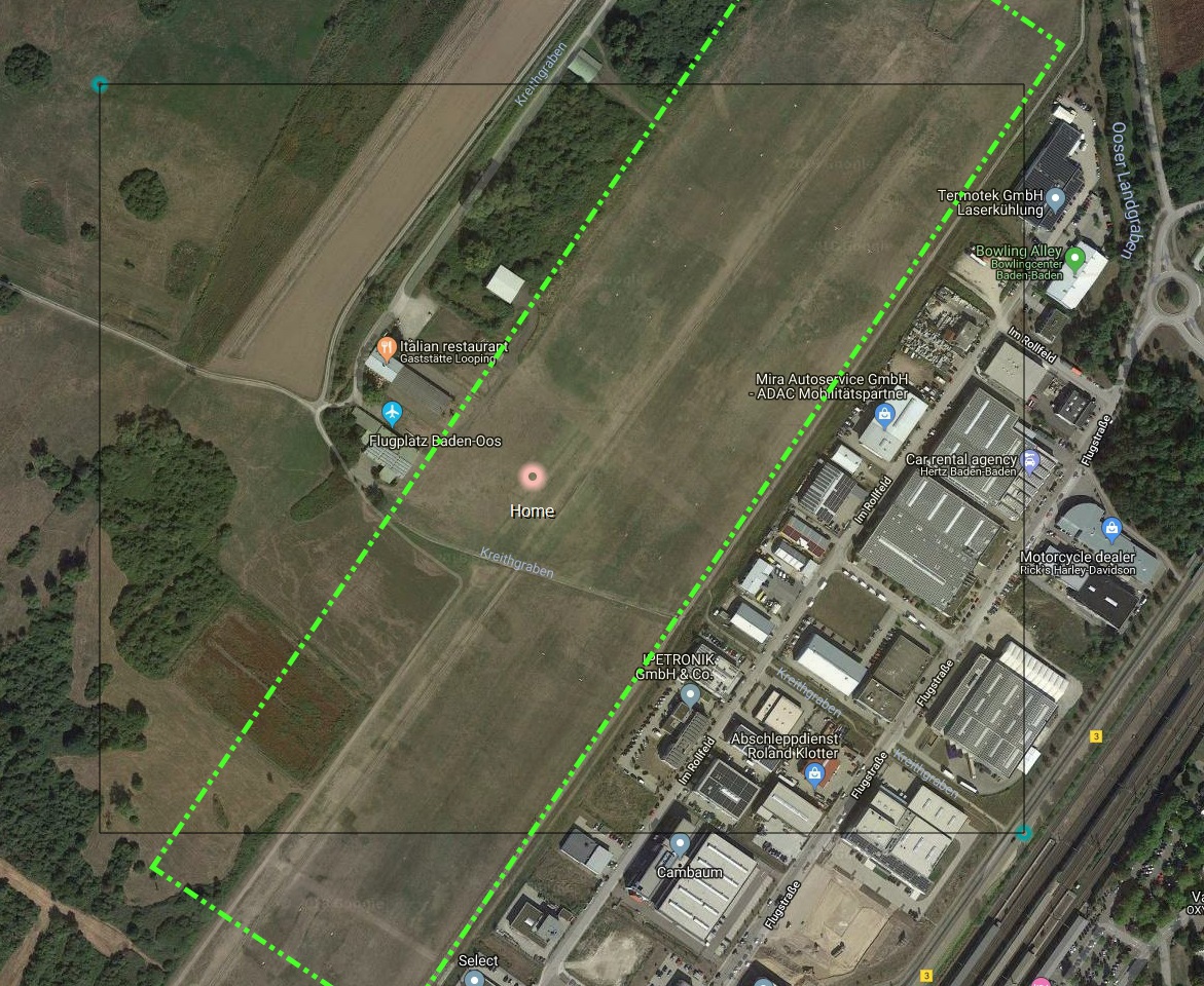

The rectangle which is genereated is not the one i need.
I need the rectangle rotated in the map.
Is there a way to rotate the rectangle in the map?
If not it would be really necessary to implent that feature, because without the Geo Fence is useless.
Here a picture from what i mean.
The yellow rectangle is what i need.
It's easy to set, and make a rectagle, but it will never form it where i would like it. Exactly as catdog has shown.
Logox2 are you able to set yours like that, with the rectangle lining up exactly where you would like it, or just an area roughly around where you fly?
Or simply a funktion to rotate the rectangle on the map. Its ok if u can do only a 2 point rectangle on the field as a quick and dirty solution. But at least at the software it should be possible to rotate the rectangle as u need.

Campbell wrote:This is the exact problem i am having.

Looking at the attachment your runway runs North East to South West or North West to South East. And the trouble you are having is setting the fence along those coordinate's. Is that correct ??
Look at the both pictures above. These pictures shows exactly the problem. Sure u can make a rectangle which is big enough that the fligjt area is in it, but that is not the goal of a geo fence. The fence should be like my yellow line. My flight field isnt in a straight line from north to south or west to east.
