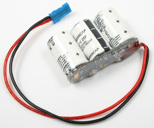

Hi I have these capacitors and I am fully satisfied

urgno
Posts: 274
R2 buffer is the Ferrari of the capacitors ;)

Genesis
Posts: 59
Joined: Thu 19. Jan 2017 2:17:34
Location: Alberta, Canada
urgno wrote:R2 buffer is the Ferrari of the capacitors ;)
Yes they sure are, too bad no one sells them anymore, at least not that I could find.
