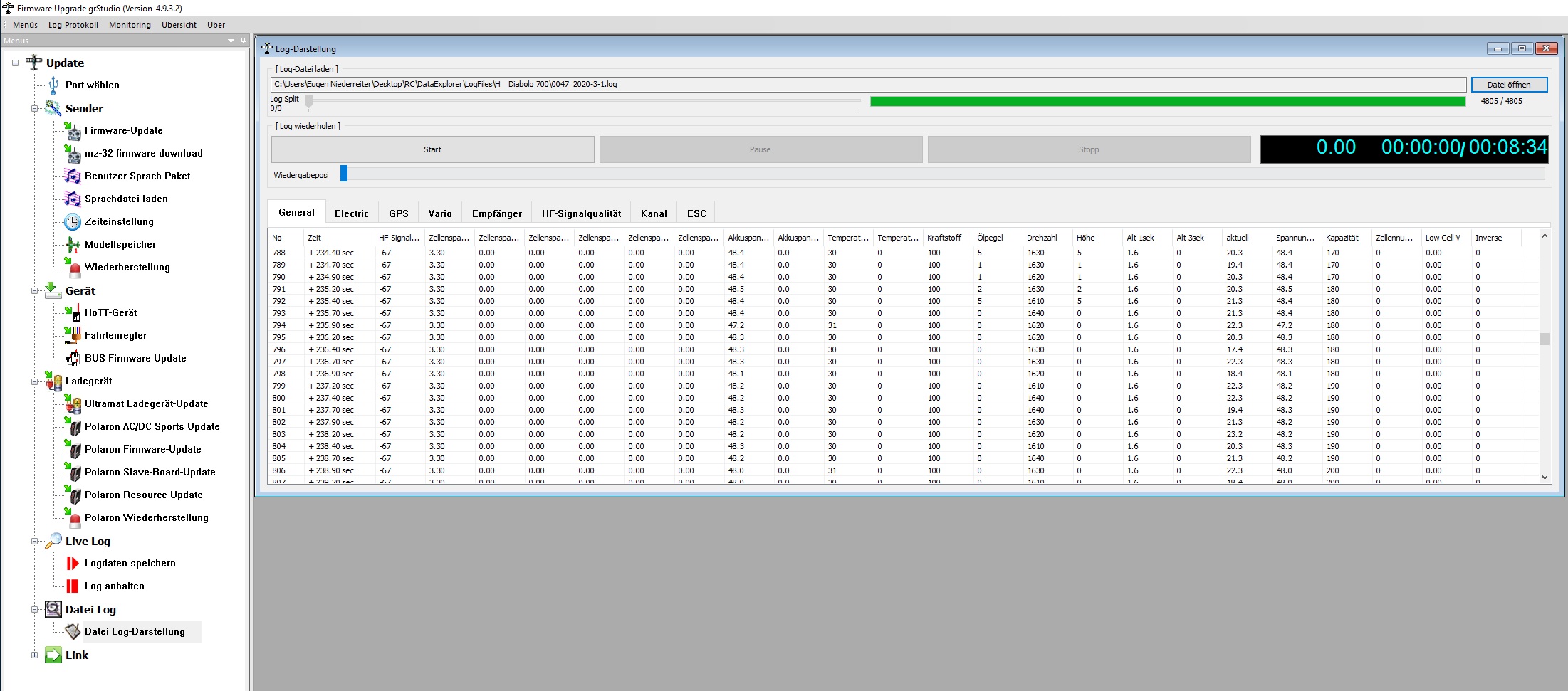

Basicly this works in my setup (Transmitter: MZ-32, Receiver: GR-24(SUMD), FBL: Spirit Pro with Geolink, ESC: Hobbywing 130A V4 HV BEC. Lastest available Firmware applied on all components.).
However, I have questions related to the telemetry data I get from this setup:
Fuel [%]
Fuel is always 100. ALT seems to be the Vibration level. Or, could it be that "aktuell" is the vibration level because it is depending on RPM ? What does this value mean ? In the Spirit Software you measure dedicated Vibration Levels for X- , Y-, and Z-axis.
BAT2 [V]
The data is there but it is always zero.
I have attached the HoTT Telemetry file and a Screenshot for documentation purposes.

are you able to check all pages in your transmitter?
We will take a photo of telemetry screen to show you where you can find voltage.
