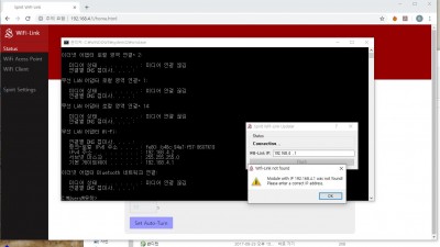

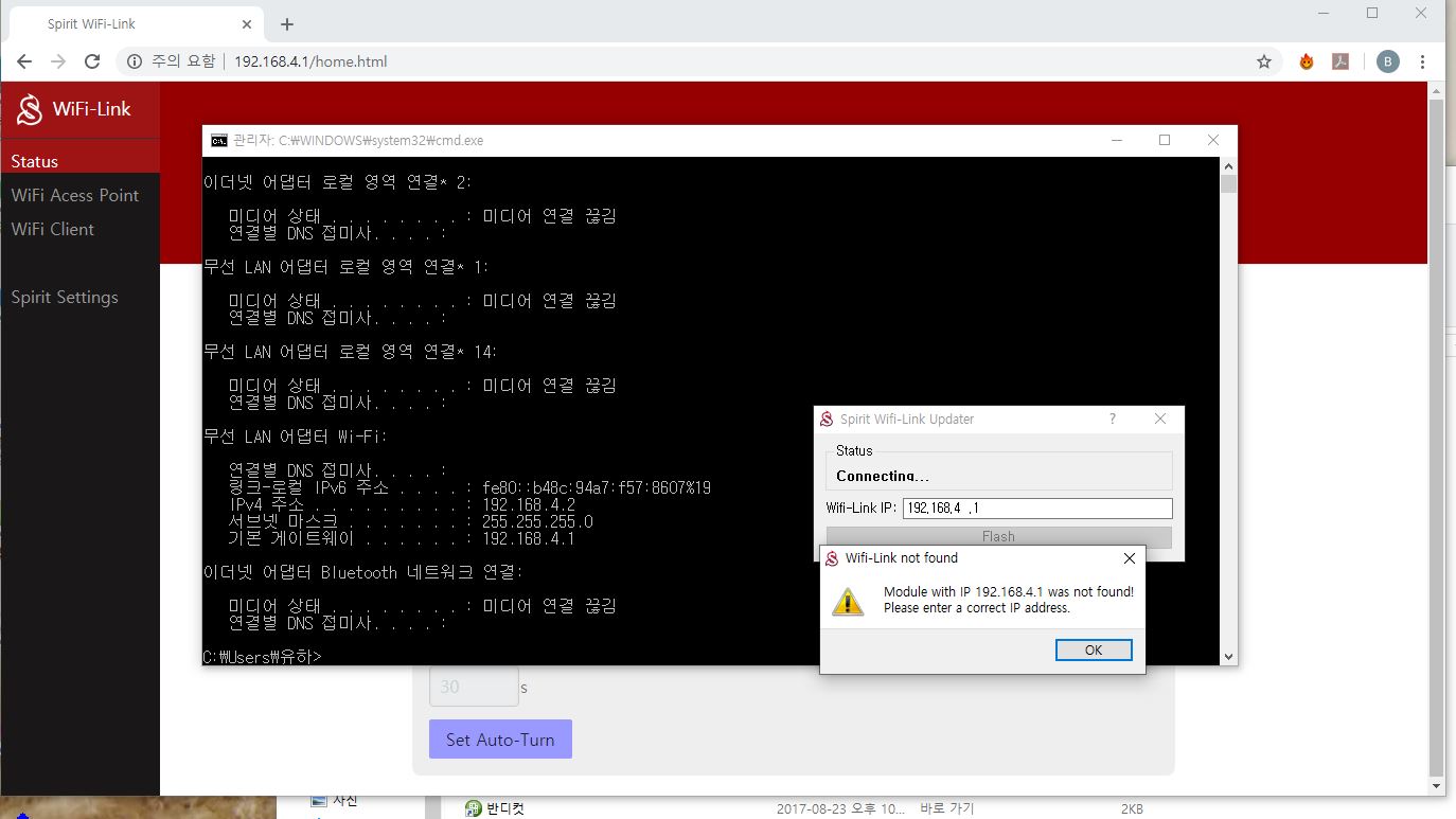

I can connect Wifi link by phone and notebook to 192.168.4.1 by AP mode
but wifi updater will not connect to 192.168.4.1
So I can't update my wifi module
I even tried client mode and also connecting by phone, notebook, desktop PC was OK with internal IP
but wifi updater will not connect to it with same internal ip
My computer is running windows 10, wifi link version is 2.0.2 and it is currently only connected to battery(Spirit FBL is not connected)
What should I do?

I have tried that and also tried adding it to firewall list.
But no good.
error message is always "Module with IP xxx.xxx.xxx.xx was not found Please enter a correct IP address"
Connecting by web browers is OK, Android App is OK, Spirit Settings is OK (by Ctrl + W)
Only update is not working
But no good.
