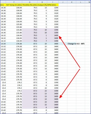

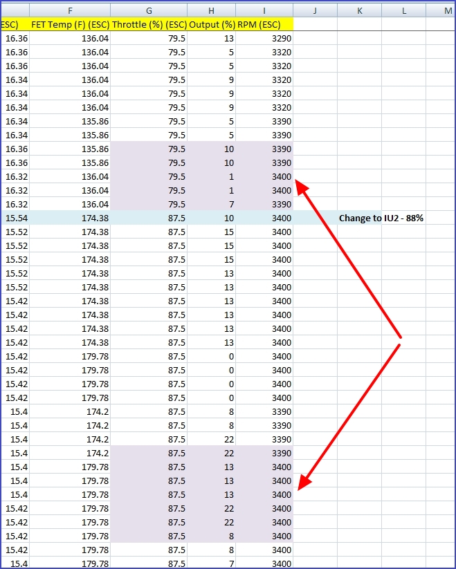

As I spool up and toggle the RPM switch, I get rpm's reported that make sense. When I look at the TLM logs, they make sense for spool up. But the HS reported when the Gov is enabled and the HS is in the flying range, seems "fixed" at approximately 3400 (+/- 50).
Today I set my Gov for 3000, 3450, 3900. During the flight, I can easily hear the faster HS, but when I toggle the DX9 to speak the HS, I get the ~3,400.

- oxy3_3400rpm.xlsx
- Telemetry data
- (111.88 KiB) Downloaded 71 times
Yes, RPM is technically limited by Castle ESC. In other words it can't technically transfer higher RPM data so it might be issue for a smaller helicopters.
The only solution would be to set Gear Ratio and motor poles in the Castle ESC which will send "lower values". Then to set both Spirit values to 1.
