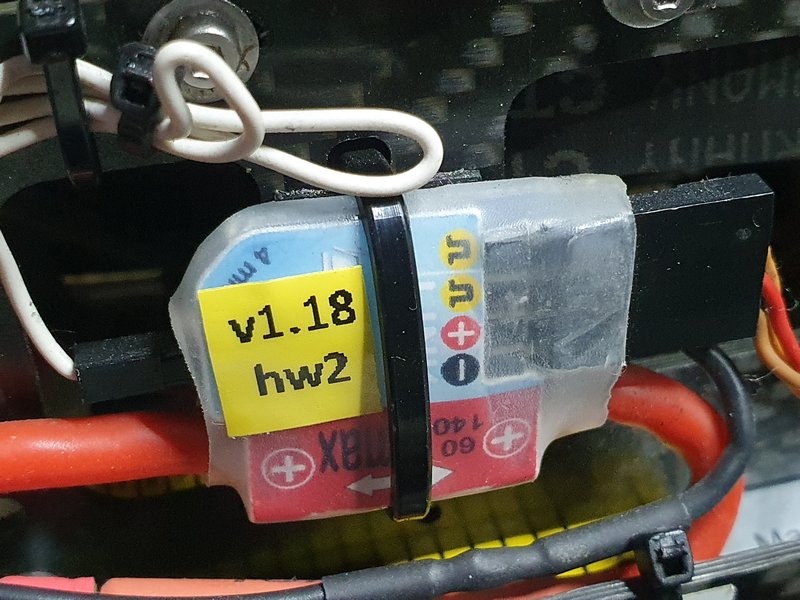

anybody tried to use an SM UniSens-E with Spirit RS?

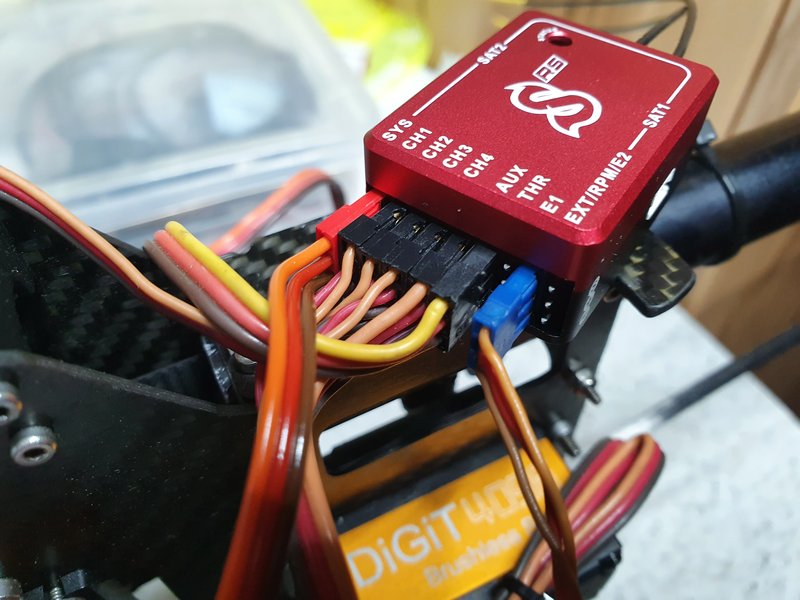

According instructions I tried it on both E1 and EXT. The UniSense was not detected in any case.
The same sensor works fine with standard JETI receivers like REX-10.

you have to set EX Bus protocol at the E1 port. Standard is JETIBOX/Sensor which is likely wrong for the sensor.

Great hint, I missed the lastest update SPIRIT-3-1-RS.zip which includes the REX-RS.bin file. Now it works!

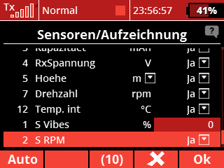

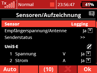

Just a minor note. The SM UniSense is listed with a label "UniS-E", but Spirit RS seems to havo no label.
