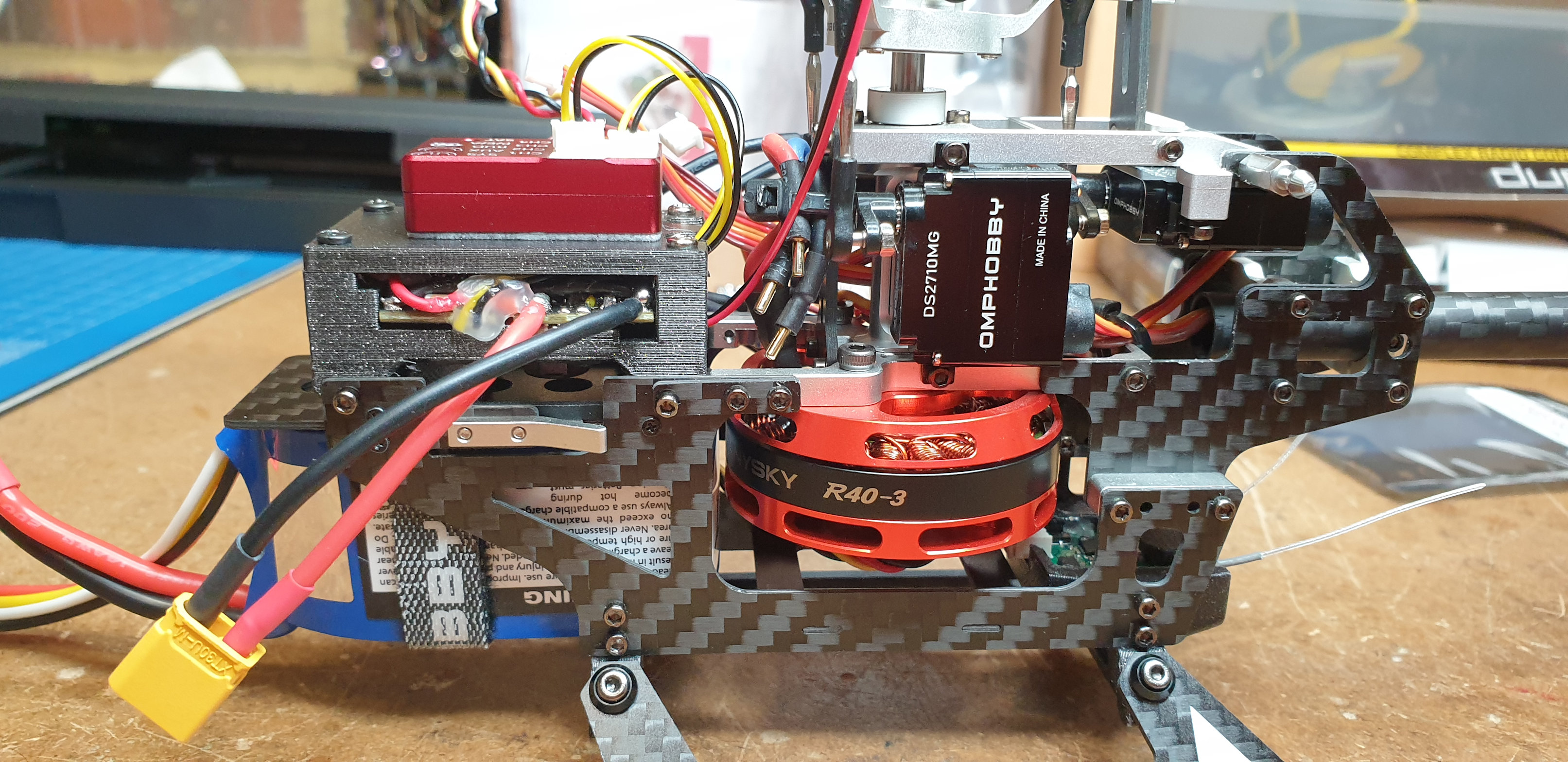

I'd like to ask for some advice please, basically I have converted an OMP M2 to use a uSpirit with two seperate ESC's for main and tail. Setup has gone well and I have gone through the various tail motor settings and all is well.
However when I go to test fly the model, while it does fly and I have control, the disk is wobbling really fast almost as if the cyclic gain dial has absolutely no effect on the cyclic gain at all.
I have tried with it all the way down at 20% and it still does it, I've even gone back up to 60% and it's still there. Apart from changing the rotor RPM which then changes the frequency of the wobble, nothing helps.
Browsing through this forum I came across others with a similar toilet-bowl effect and one idea was to make sure the compensation were all set the right way and I have gone through this about 6 times now with no change on the problem I am seeing.
Not new to helicopters and FBL, but new to Spirit so was originally convinced i was missing something to start with, but now feeling it's a software issue more than a setup one.
Any help will be appreciated.

Thanks for coming in and also for the compliment on the layout, I am quite pleased with how it's turned out and will no doubt make subtle changes as I go along. Have another Little Bee ESC coming in with the older BLheli for the main motor, as the current one is BLheli_32 which I cannot flash the MAIN firmware to.
Yes fully agree, the mechanical setup can make of break a machine and being old school I am always on to make sure my bench setup is perfect. The only error I did make origianlly was reverting to the Vbar way of using sub trim to centre the sliders in the software, I soon found this was wrong and just concentrated on travel limit values and let the unit determine the right centre positions.
