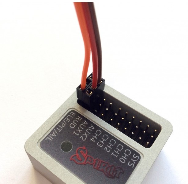

SPM4649T (w/ Spirit integration cable)

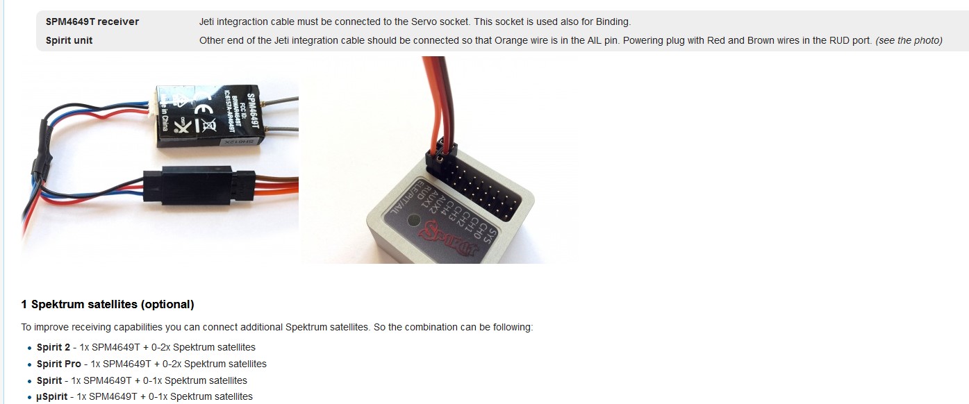

in the manual you can read like this, I hope it helps -
Best Regards
Matthias
Best Regards
Matthias

when I do understand the manual right, then you have with the telemetrie from hobbywing ESC (Sat Port1) only Sat Port 2 for one additional satellite -
On the other side you have to connect one SPM4649T to ELE/PiT/Ail and Rud -
I you have only Integration without ESC-Telemetry you have the posibility to add up to two satellites depending on which Spirit FBL is used, see also attached appendix -
