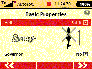

wie muss die Einstellung aussehen, wenn ich NICHT den Spirit RS Gov nutzen möchte?
Ich möchte den Hobbywing Regler Gov verwenden...

Governor at the screen is not related to Spirit Governor. You can avoid this option in any case, even if Spirit Governor is used.
You do not have to do anything if you want to use HobbyWing Governor.
Only set Throttle Curve in the radio.
