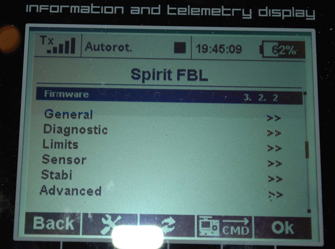

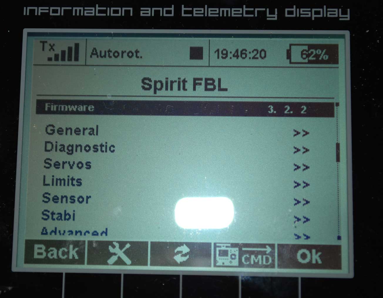

I came with the new 3.2.2 Software, so I updated the files on my transmitter (DC16, newest sortware).
The Integration menu looks normal when started for the first time, after entered the
diagnostic menu and left it again the main integration menu looks incomplete, the servo tab is missed and other
entries ar no longer available.
Do you have any idea ?
Perhaps it has something to do with the bank switching, i dont want to use that and i do not assigned it to
a channel.
Thank you
Till
Posts: 12929
Dear Till,
could you please try to update to 3.2.2-r2 firmware version? It is available in the Spirit Settings from now.
I hope this can help you.

I´ve tried it - and what can I say, now it works perfectly.
Thousands of thanks and have a nice weekend :D
