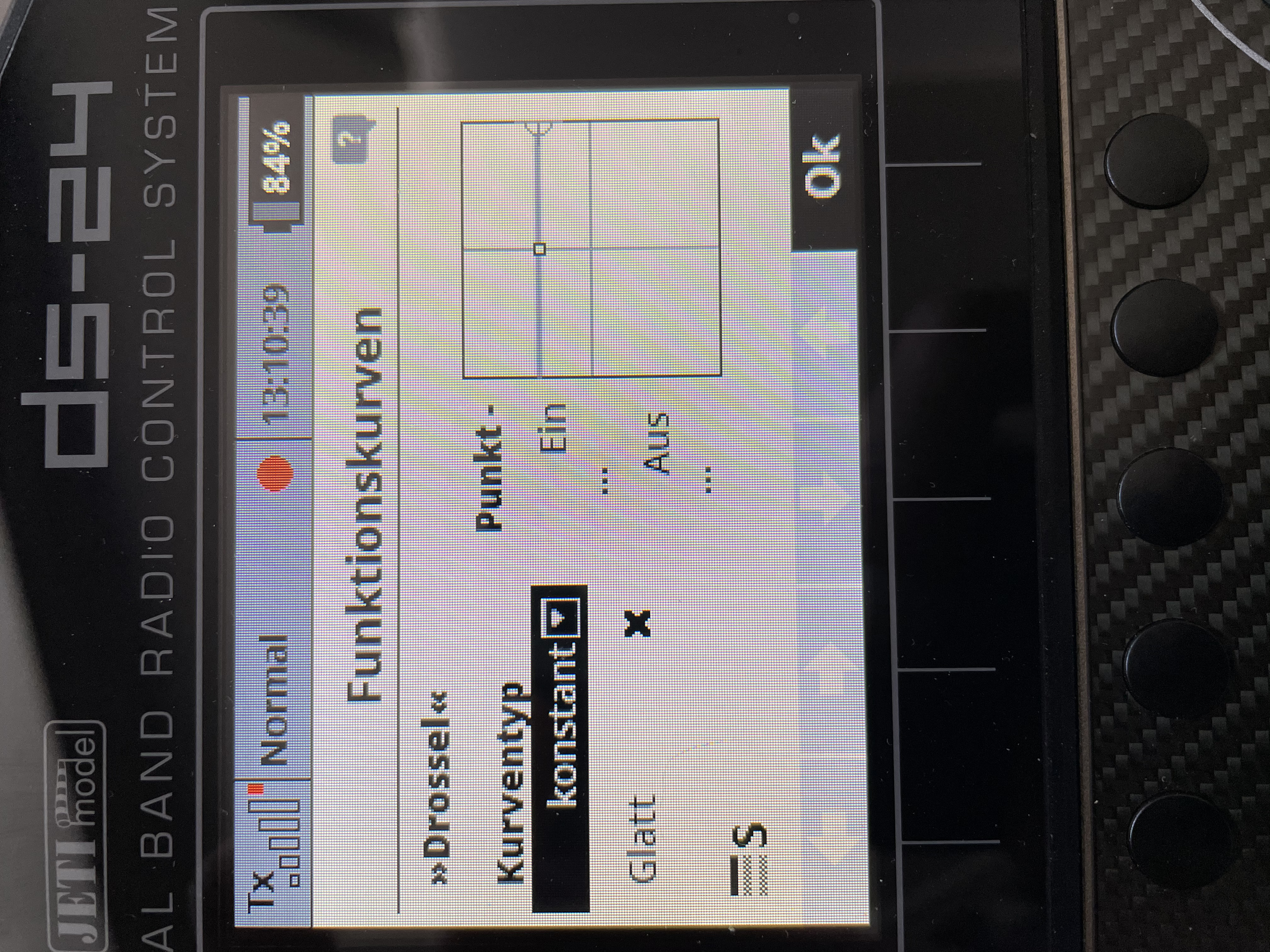

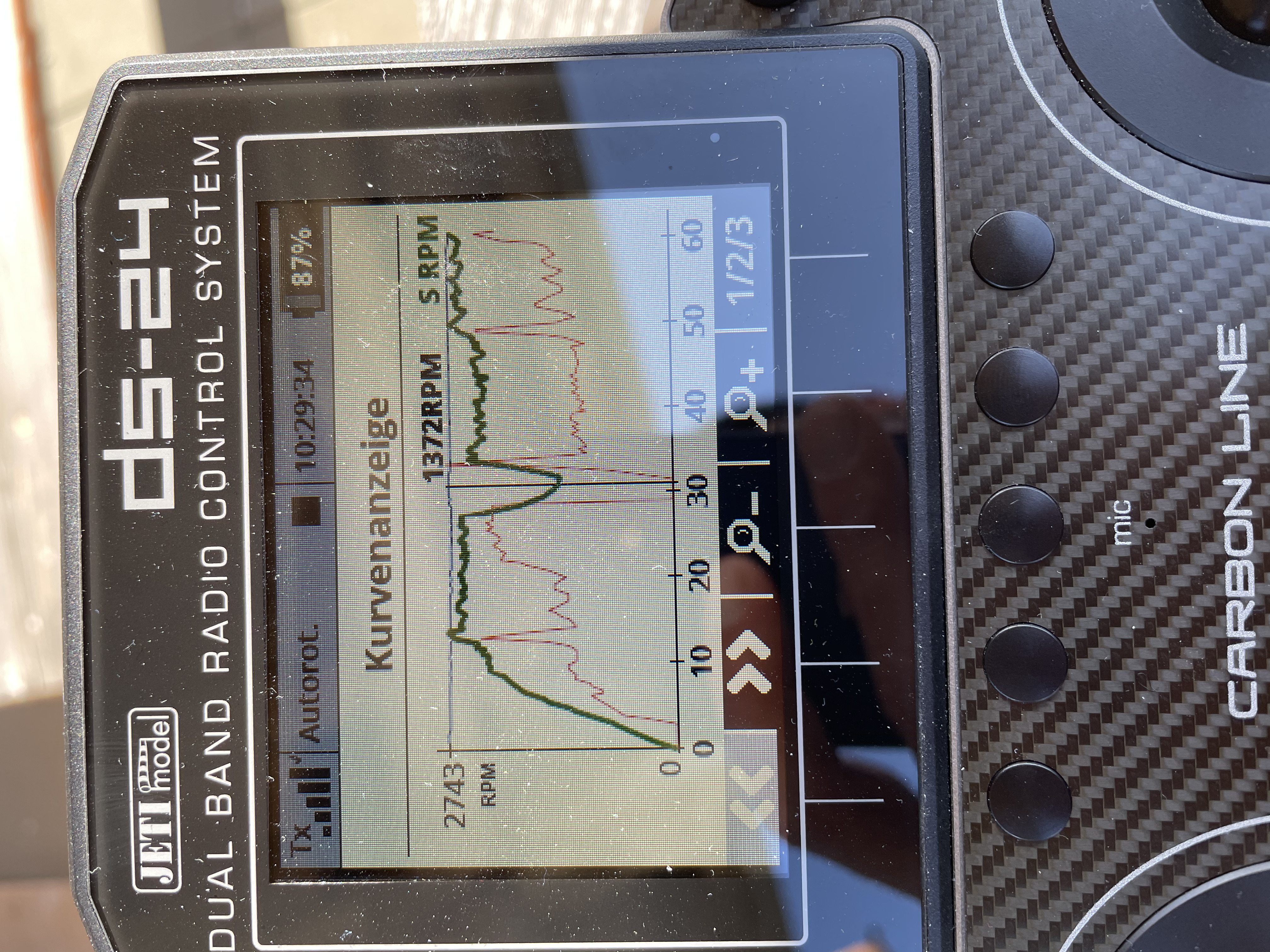

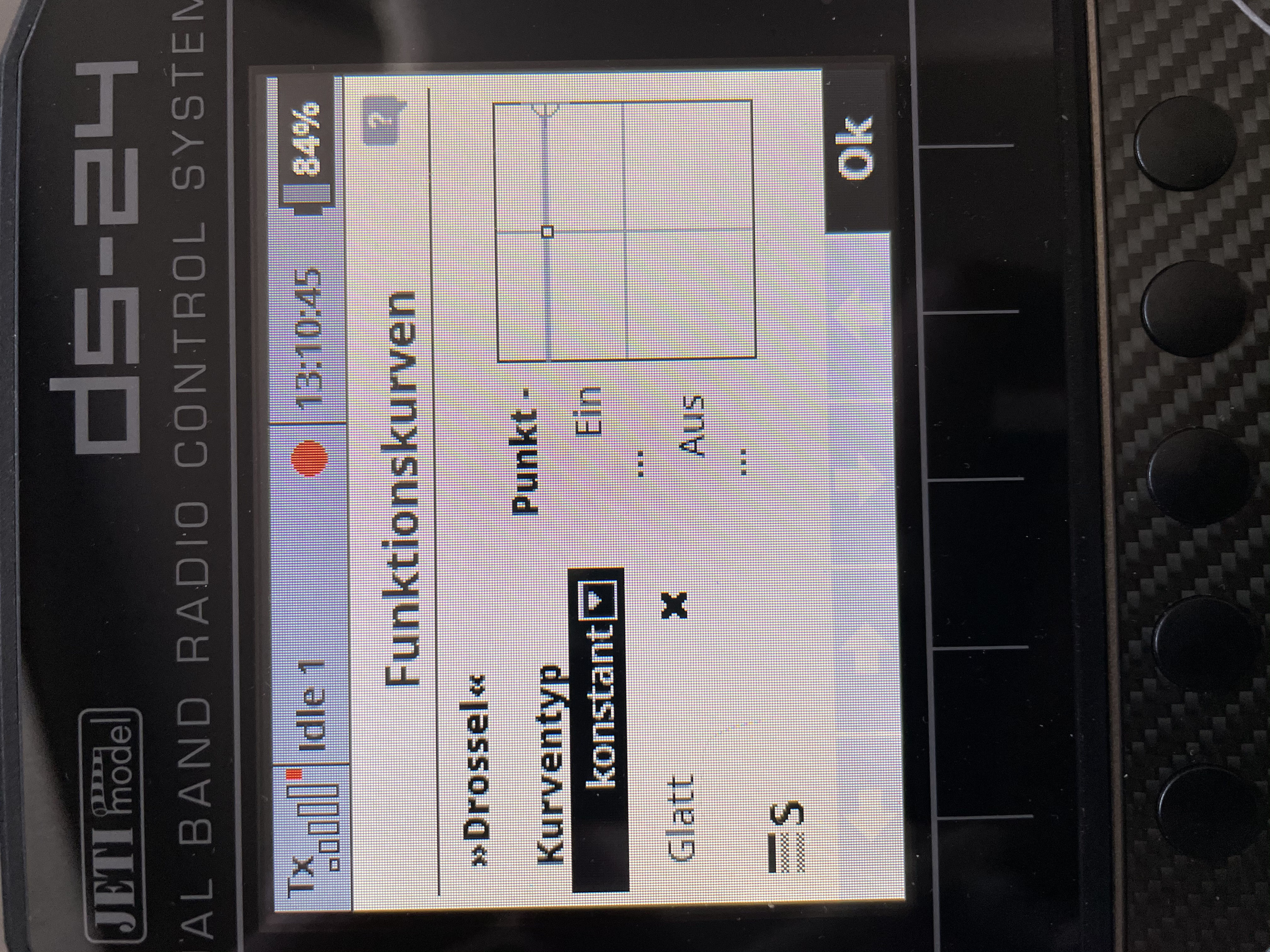

Yesterday i changed my RPMs for the first time from 2200 to about 2500 (through flight mode, Normal to Idle1) took off and suddenly had a RPM collapse to 1370 RPM, as you can see in the Jeti Log.
"RPM sensor data are to noisy" was the only entry in the spirit log, I change the RPM through flight modes (Heli Setup) an constant curve:
Anybody an idea?
Anybody an idea?

Isnt there some other throttle curve? I guess the problem with RPM is due to programmed Throttle Range is out of range ESC know.

No there is no other throttle curve, only these 2
