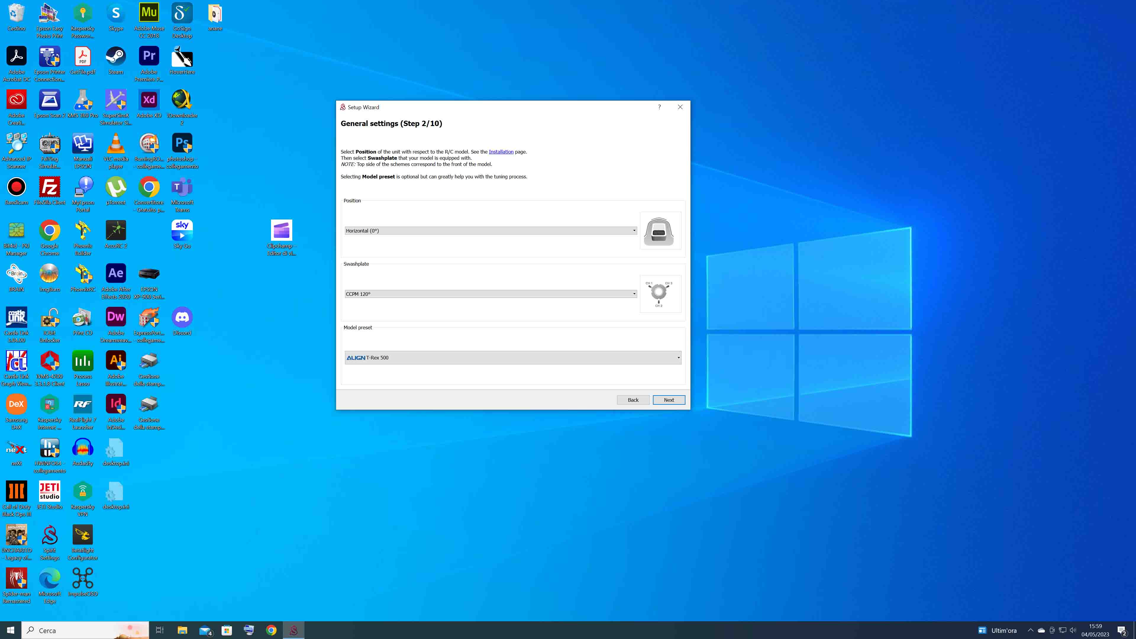

But I want to say one thing that I have seen from the beginning.
in the software if you choose the preset of trex 500 goes out swashplate 120°
but the trex 500 it has an elevator towards the tail Therefore this model he's called 120° reversed.
Another example
if i select protos 380 goes out 120° reversed
and elevator protos 380 it is located on the nose then it is called 120°
Why in the software spirit the name reversed it is used in reverse ?
120° -r r signify retro and retro is tail.
I've always wanted to ask this thing
vvv850
Posts: 89
Joined: Mon 29. Jan 2018 10:52:34
Just select the swashplate orientation of your actual position and ignore the default selection if it is not like yours. The model selection is used for some default flight parameters like flight style.
Posts: 13048
You are right, that Trex 500 has elevator servo at the rear. And for this reason it must be configured for "CCPM 120°". Not Reversed.
So preset is correct. I dont understand what is wrong from your description.

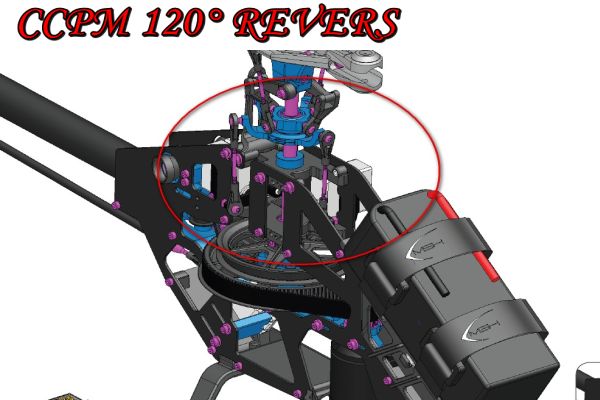

Posts: 1068
to franz88:
Software Spirit is OK.
Manuals Trex500 and Protos380 is OK. (photo:)
Look for an experienced rc heli modeler in your area and solve the vibrations and settings first.

ok i tried to avoid saying that till the end because it didn't seem right show it
I set up other flybarless and in other flybarless they use another system Now I don't know which one is right given the misunderstanding
