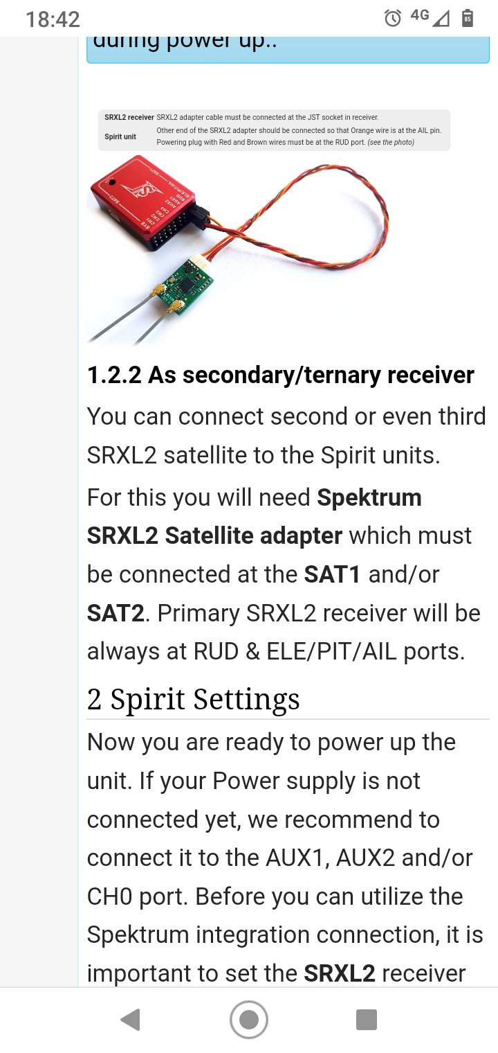

I don't know if you looked at this - there is no word of DSMX-Sats -
https://manual.spirit-system.com/index. ... trum_SRXL2
The only FBL that works with SRXL2 and an DSMX-Sat as I know is not Spirit -
Was this statement from Jeff West? Normally I believe his statements, but I think he is wrong - neither in the current instructions nor from Tomas is there any statement that a DSMX satellite can be installed parallel to the SLRX2. can be operated, the request was here some time ago and as I remember, Tomas said that it wouldn't work -
If a DSMX-Sat lights up, that doesn't mean that it works, it just means , it is supplied with voltage and it has been linked to the remote control, so be careful here!

Unfortunately old DSMX satellites will not work with Spirit units together with SRXL2 that are communicating at a different protocol.
For running multiple SRXL2 receivers/satellites we developed binding process that can be triggered directly from the Spirit Settings software.
This will bind all receivers properly with only one to send telemetry data. So issues with corrupted telemetry will be resolved by this.
I think we can share the software from tomorrow if someone is interested.
