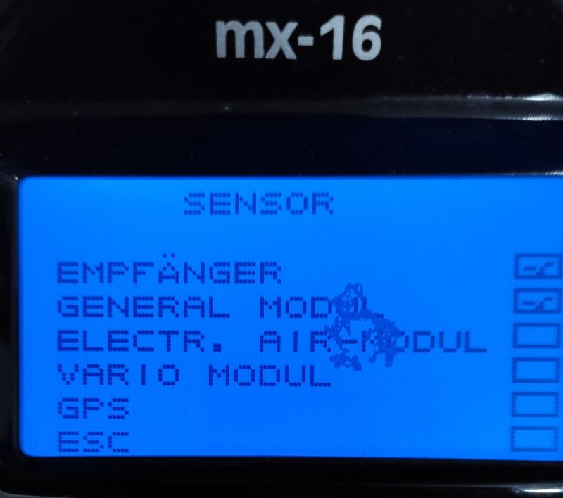

Hello Michael, thanks for your quick tip. I have already discovered the instructions you mentioned and tried to follow them. Unfortunately I can't get any further. It seems that the “general module” is recognized as shown in the picture. But now I can't get any further. I also can’t find the “option SENSOR at Chx” setting. However, this setting probably only applies to the GR-12 receiver. I have GR-16 where SUMD is set to CH8. Maybe you have a tip from your experience with GR-16 and Sprit GT? Thanks in advance. Dieter

Posts: 13045
It will work for sure.
You only have to select correct sensor in the radio.
This is desribed in radio manual.
I think it is pressing of some two buttons.
Try pressing two Arrows as described in our guide.
