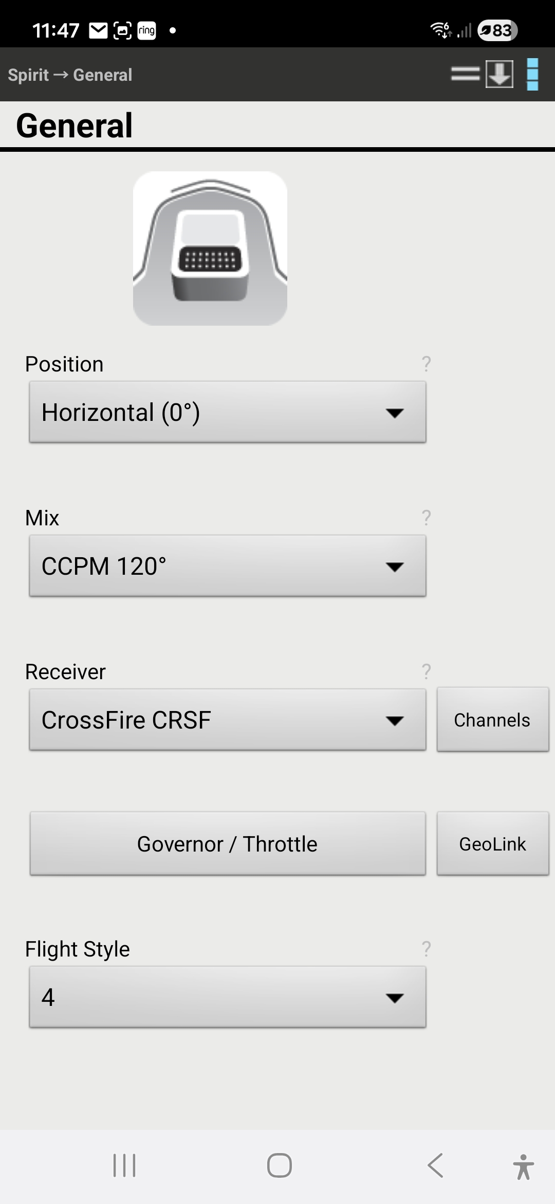

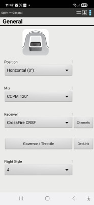

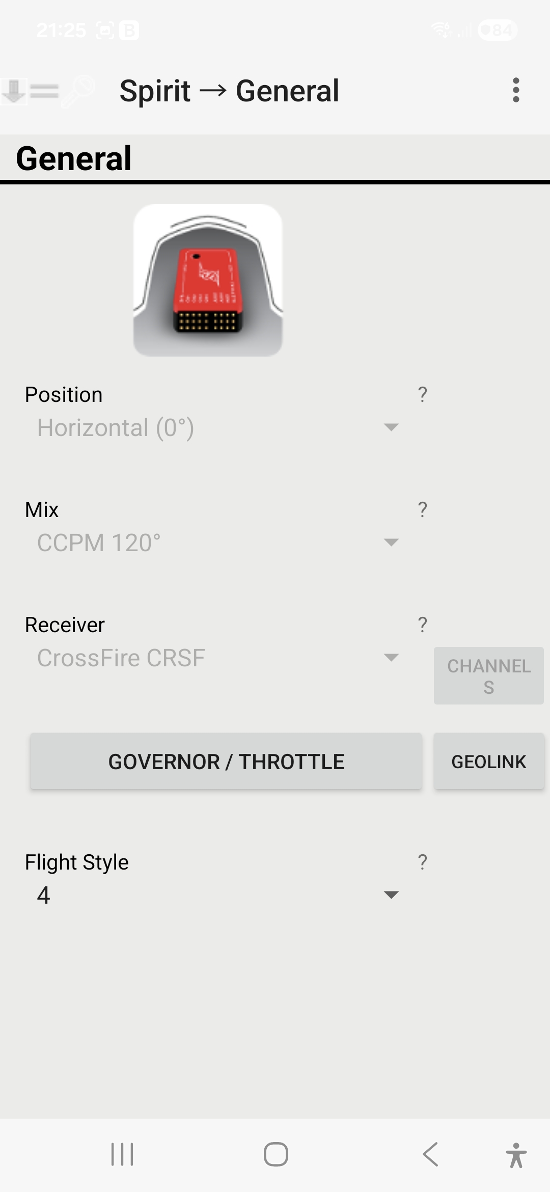

I'm still having problems with the latest official version of the app installed from the Google Play store. Some of the sub-menus & parameters are greyed out so they can't be accessed or modified e.g.
In the General menu, all of the settings are greyed out including the Channels sub-menu tab.
In the Servos menu, all settings are greyed out.
In the Limits menu, the Cyclic Ring and Rudder End Points settings are greyed out.

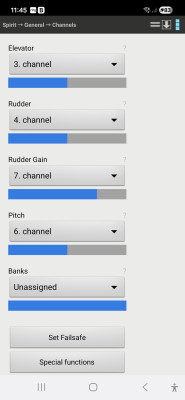

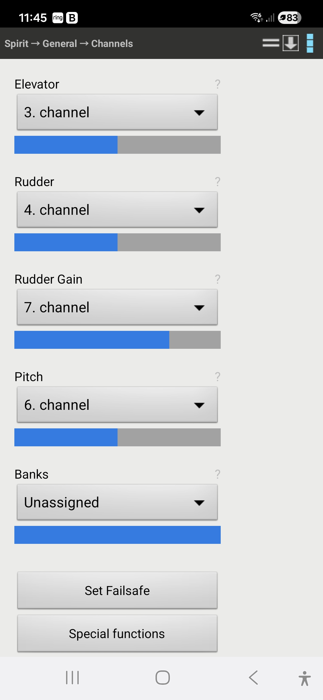

This problem does not occur in the 4.0.0r3 version of the app & I have full access to all menus & parameters as soon as the connection is made via the Spirit-Link BT module.

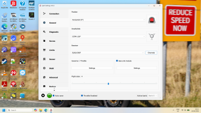

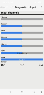

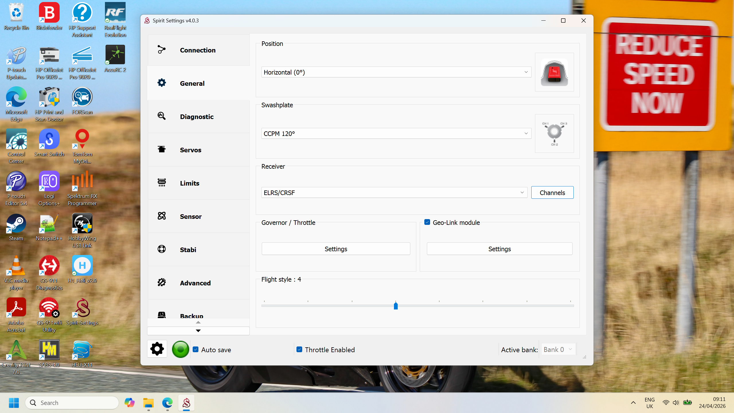

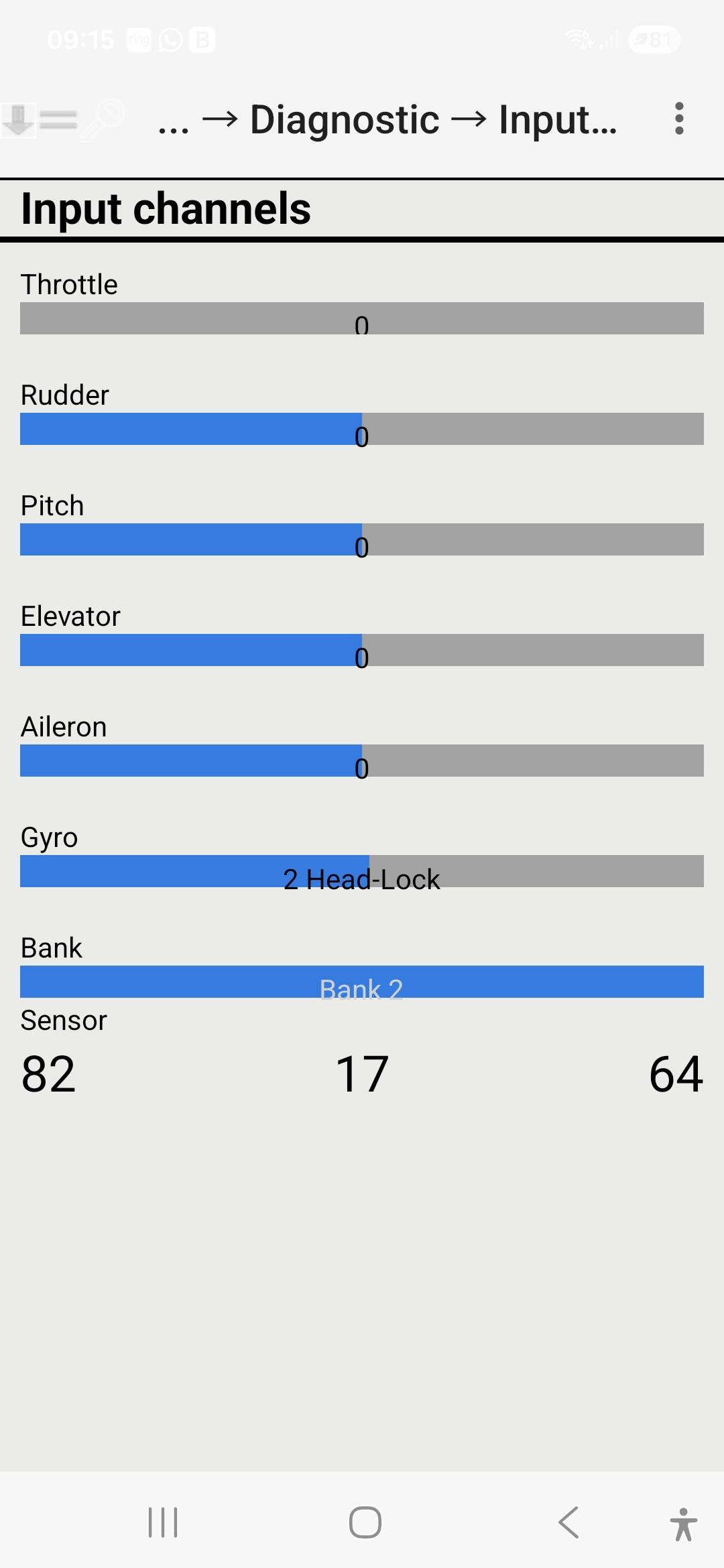

I don't use the Bank function. It is unassigned & in the Windows application, it shows active bank 0, although strangely in both versions of the Android app "Diagnostics - Input Channels", it says Bank 2.
Screenshots attached.

in this case it could be Basic mode that will not allow you to change base parameters. This is safety function that can be enabled/disabled from menu.
Many thanks for the quick response.
Yes, that was it. Having found "Basic Mode" in the settings menu (the 3 vertical dots on the General page), I turned it off & now everything is accessible as it was in the 4.0.0r3 app.
Is this a new feature in 4.0.3 or was it turned off as default in the 4.0.0r3 app?
You are welcome. It is turned off by default. This feature is present for many years already.
