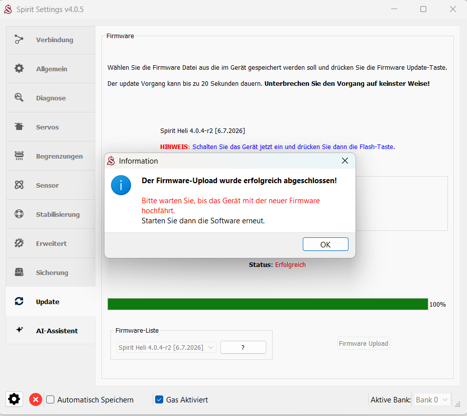

Hello
Thanks to your instructions, I was able to complete the update successfully.
During the update, the LED was flashing. At the end, I received this message. After that, the Spirit did not restart automatically.
I closed the application on my computer, disconnected the Spirit from the power supply, and then reconnected it. The Spirit now starts up as before (the LED briefly lights up when it is connected to the power supply).
The application on my computer does not detect the Spirit.

can you please send me a message with serial number of your unit? It seems we have to recover part of the memory, because during update it was lost. It can be done using special firmware. Old 3.7 had no backup that is used by more recent firmwares yet in case like this. So after update, everything will be OK and the issue should never happen again even if you interrupt power during flashing.
