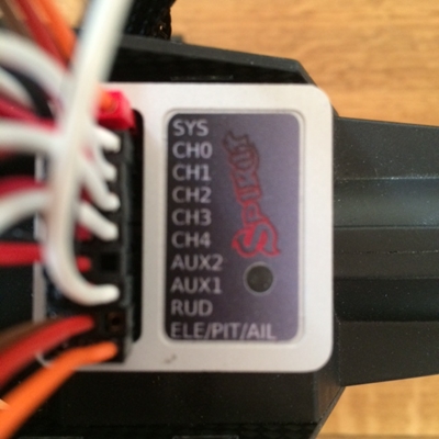

Just one more addition to demonstrate the point. Note the difference between the Spirit Pro and the Spirit...... pins are in different locations.
Spirit Pro.JPG (93.81 KiB) Viewed 6084 times
Regards,
Heliman550
W.W.
Posts: 65
Joined: Mon 01. Feb 2016 13:37:12
What is the real difference?
The Pro has the channels CH0 ... CH4 instead of CH1 ... CH4 (one additional swash servo) and AUX1, AUX2 instead of AUX (one additional aux port).
Ok ... the order of CHn is swapped to.
But when you look at the labels for the important ports there is no real difference. The Jeti cable has to be connected to the RUD (brown and red) and ELE/PIT/AIL (orange) port. The servos have to be connected to CH1 ... CH4 as stated in the manual, except that you can connect 4 swash servos to the Pro for 90°/4-Servo swash plates.
regards Wolfgang
