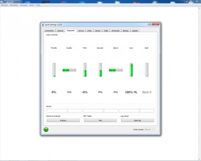

Posts: 12868
What do you see in the Diagnostic tab? - this is important.
velocity90
Posts: 252
Joined: Sun 26. Oct 2014 9:53:53
will reconnect, 1 minute
velocity90
Posts: 252
ZeXx86 wrote:What do you see in the Diagnostic tab? - this is important.
0%
