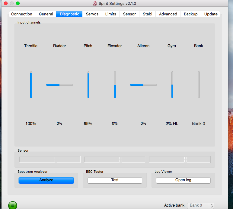

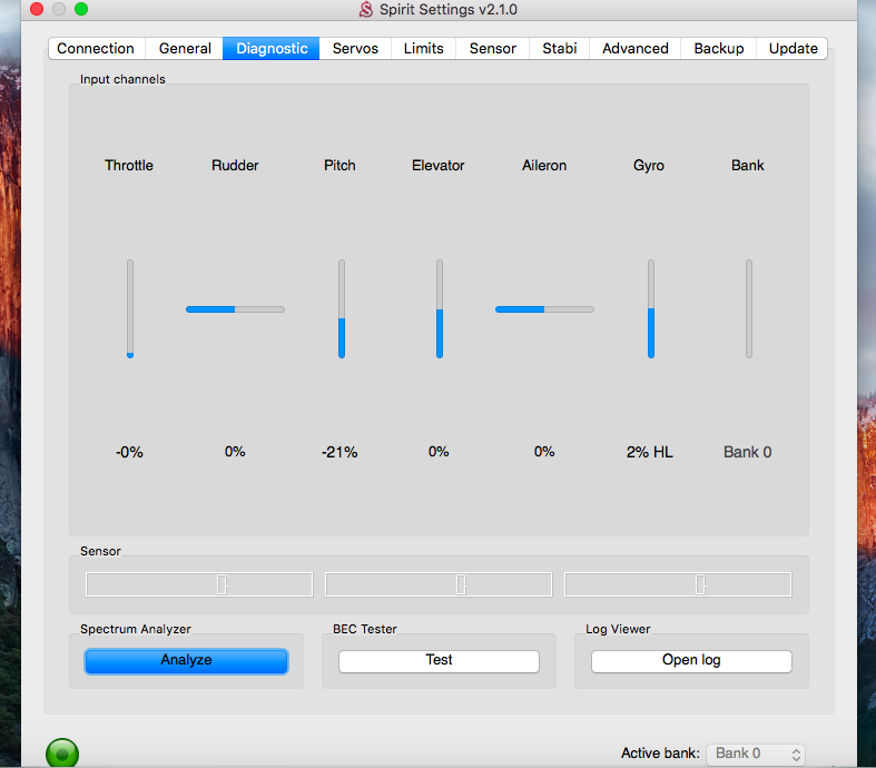

Here are the screenshots showing i have 0-100 in Spirit software.
