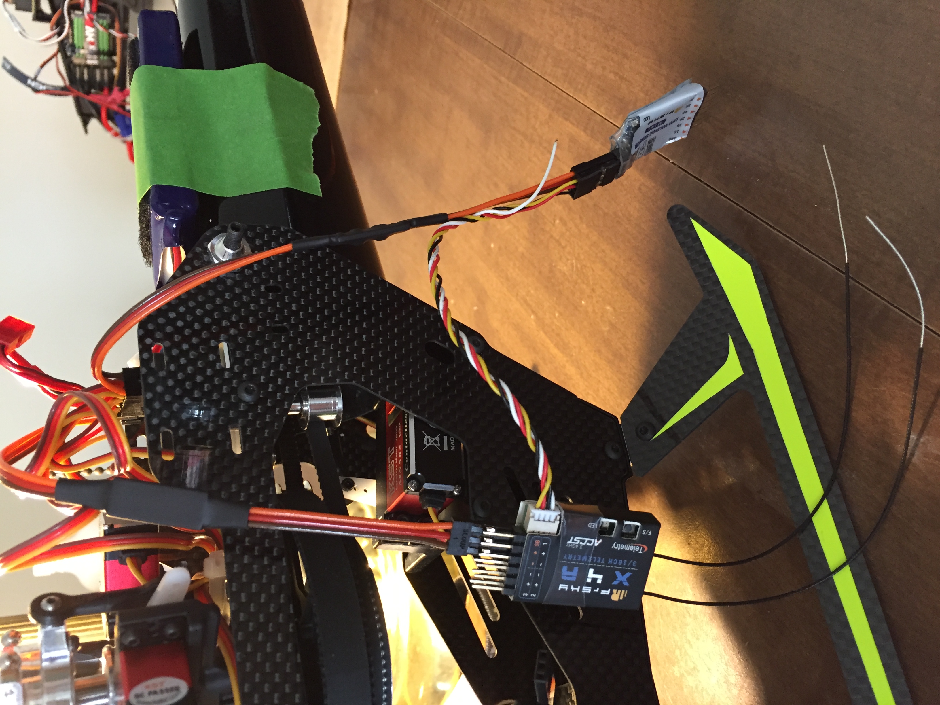

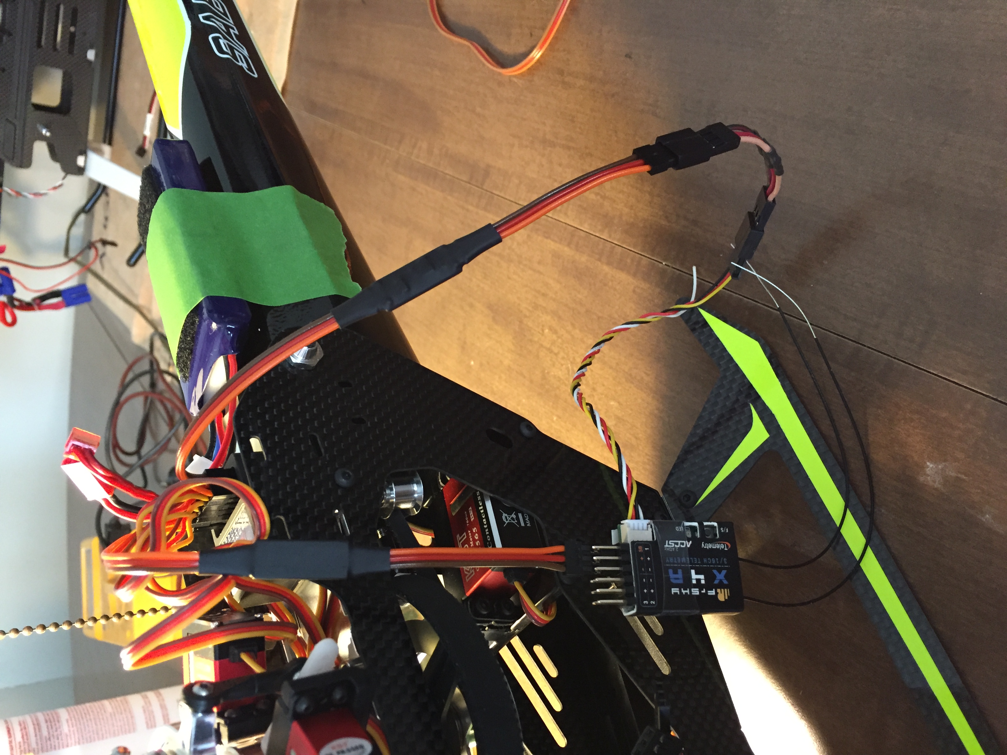

I can find nothing wrong with the connections. Here is how I have it wired up.
This is without the mlvss
This is with the mlvss connected

It is looking well. Unfortunately I can't see inside the adapter (white/red/black wires)
One last thing, but quite important that I have forgot to mention..
How far is the transmitter from the model when testing?
Unfortunately when transmitter is too close to the receiver, telemetry link is not stable. Then the connection will be very slow or not work at all.
Moving it a few cm further will solve the issue completely.
This might be a worth to try.
