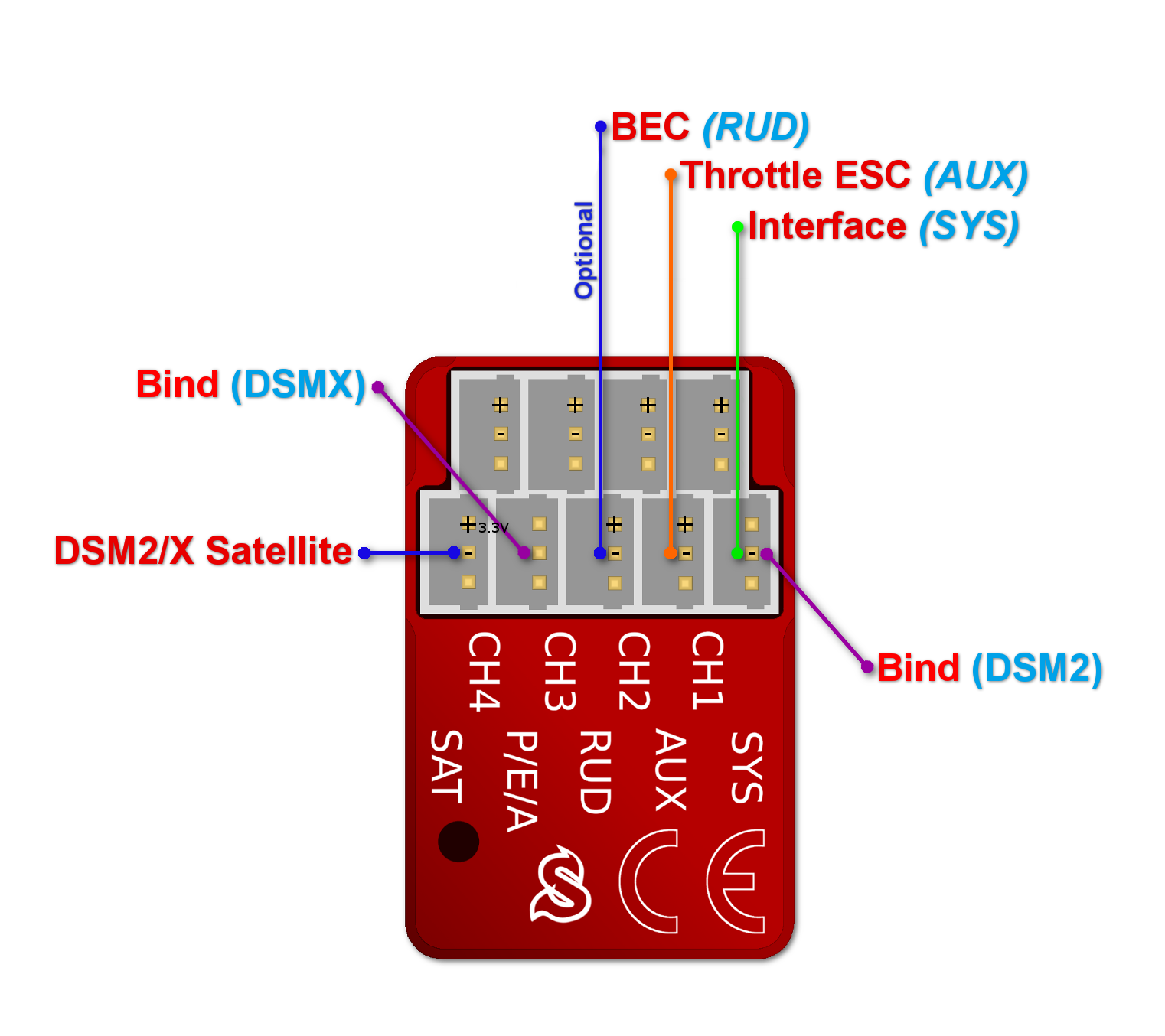

Tomáš, I think we all need a sort of diagram on the online manual to make sure these things are clear... I will receive my uSpirit tomorrow, and I bought the Lynx adapters... I wanna make sure they are fine, but I need a visual reference ("the closest pin" and "the last pin" do not mean much to me).
I was planning to use them for the tail servo and the USB adapter, now I am not sure...
Posts: 13047
I hope that this will help.
Pin layout is same with for example uBrain and other units that are using JST-ZH connectors.
So once you will use our or compatible adaptors, it can't be connected wrongly.
Also no modification for Spirit USB interface or other peripherals is needed.
