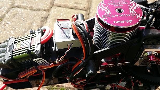

I received your longer cable and decided to try my second geolink on my trex 700x. I tried to route the cable as far away from anything electrical as possible and have used tape to hold the cable in place.
I have found the return to home action very simular to my 600. Sometimes it comes home and sometimes it flys off.
When connected to the spirit settings software and the heli is stationary, the readings for X - parallel and Y - perpendicular are very unstable. Both varying all the time jumping from -2.2 up to 5 degrees and anything in between, is this normal?
I thought it might be because the output from the spm4649t was causing interference. I disconnected it but the readings still jumped around. I also lost proper control of the servos, I thought the additional receiver on the RUD channel would have taken over?
Posts: 13039
unfortunately no, it is not normal. The angles should be perfectly stable within 0.1° range. This is really strange.

Just a quick update. I found that the cooling fan on the hobbywing ESC was causing the unstable level readings. Disconnected it and the readings were rock steady. Had 6, 6 minute flights today with roughly 30 return to home operations. It only went awol once :)
Posts: 13039
Thanks for the update!
You are right, in some cases people found out the same thing with HobbyWing ESC fan. After replacement to other or disconnecting it fixed all the problems.
