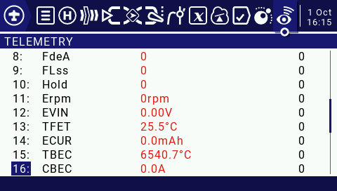

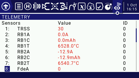

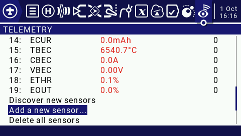

Still not working, having the same setup except receiver is SRLX2 4651T.
Also the deiscovered telemetry sensors seem strange. No flightpack voltage, strange temperatures and current readings while this is not supported in the HW Platinum 60A v4.
See screenshots of detected Telemetry sensors.
Something is wrong here. Anyone a clue?

Oh !
I didn't notice that you are using a Spektrum RX....
In this case, I can't help you. I'm only using FrSky receiver.
To be honest I don't think it can work, OpenTX LUA script are only for FrSky Receiver.
Spektrum telemetry is not working the same way.
