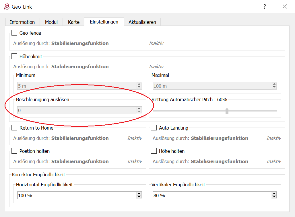

enied
Posts: 107
I have set the lower limit to 6m to give the GeoLink a chance to react and I also experienced delayed rescues at the lower altitude limit. I set the parameter shown in the picture attached to 8, which is a great improvemet.
Best, Eugen
