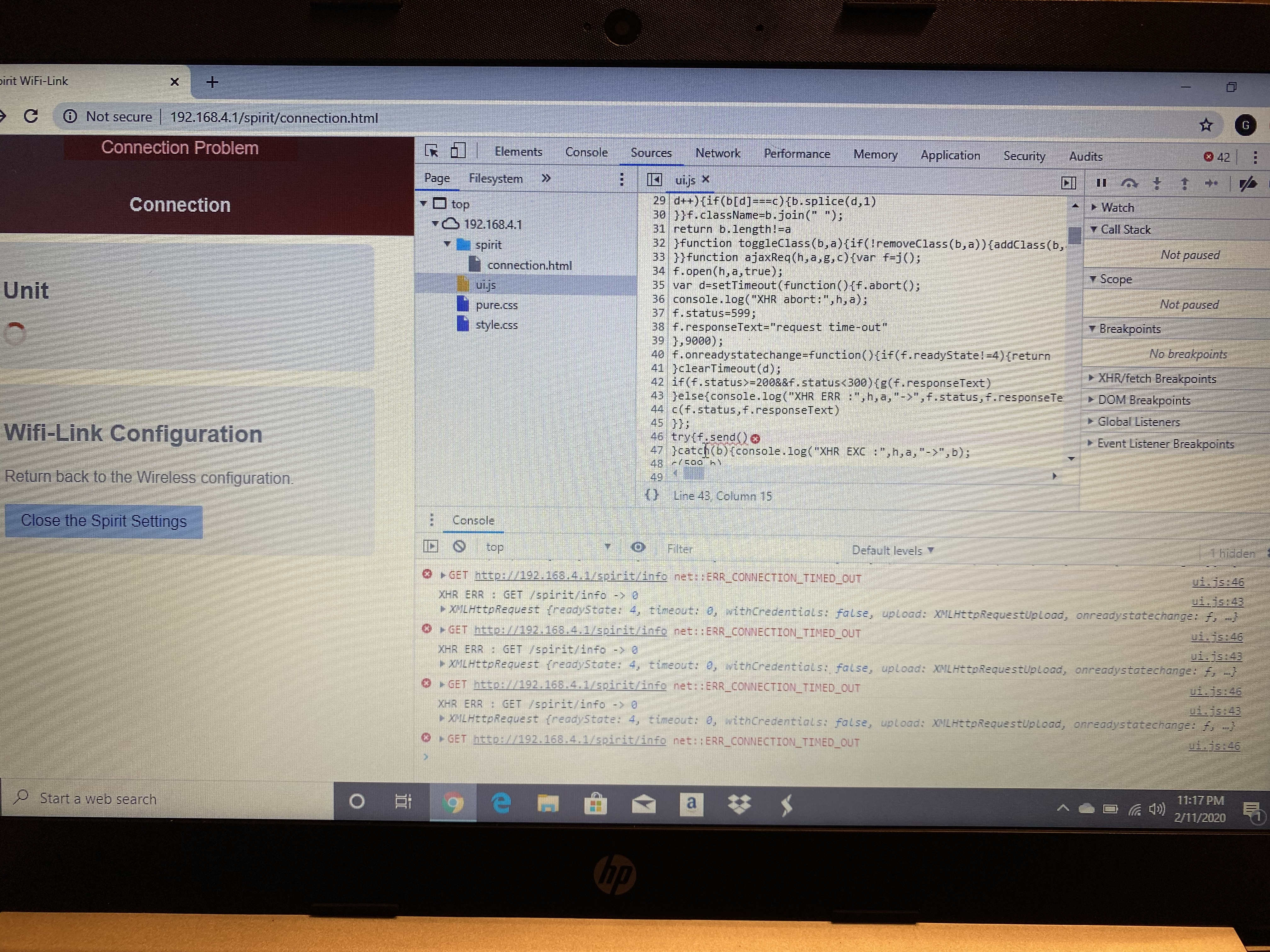

ok, had a chance to pull up the debug interface. I have attached a screen shot below. It appears that the info json doc is empty.. but not knowing the structure of the website, I didn't debug any further.

hmm, screenshot didn't attach for some reason, so trying again... and reason for screenshot is I had to use my wife's laptop and she wasn't available, so I could get on get the app up, but didn't have access to her email account to send it to myself so I could post it.
chrome debug console view
Posts: 13058
Thank you, this is very helpful.
From this we can conclude just that:
a) Wifi Link communication cable is connected improperly
b) Wifi-Link is powered from a battery or other source.
If the same Wifi-Link is working well with other unit, then there is basically no other choice.

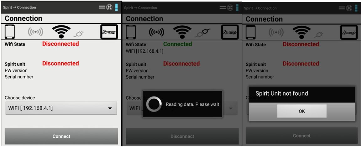

I have also used the Android Spirit app, without success. The error is following:
Wifi State: connected
Spirit unit: Disconnected
"Spirit unit not found"
I have tested the firmware versions 2.7.1 and 2.8.0, without success.

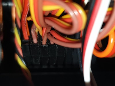

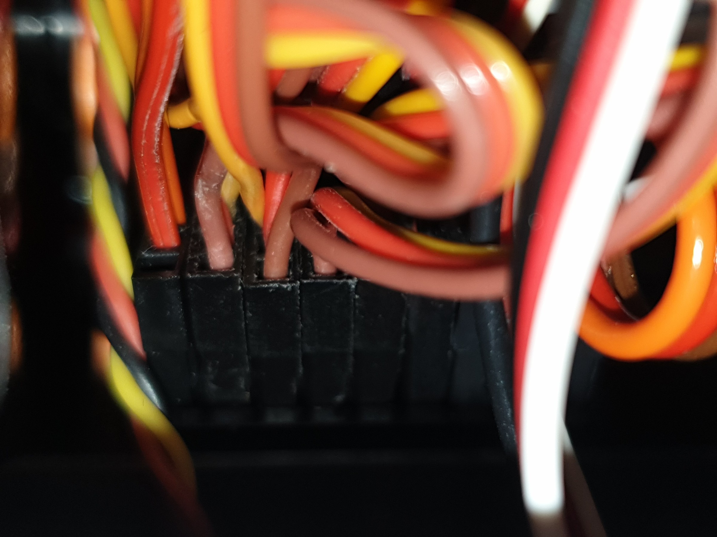

could you please take a photo of the Wifi-Link connection to the Spirit unit?
Thank you very much.

I have just taken the pictures in this order:

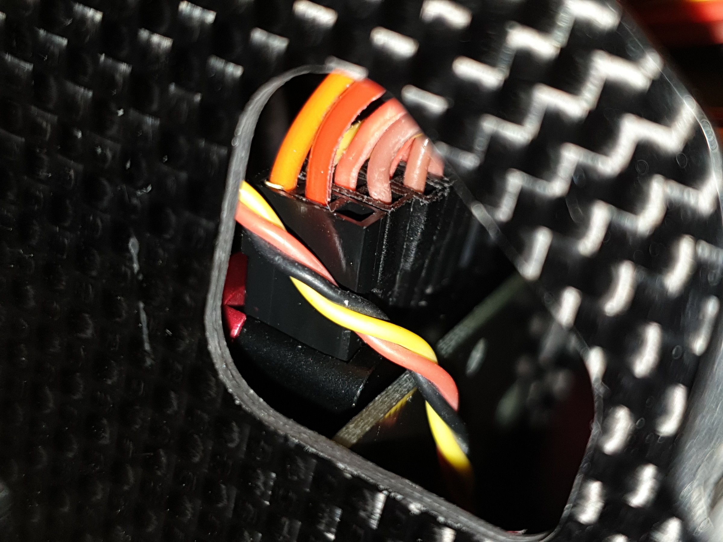

I thought photos of the wiring.
Basically if you will disconnect communication wire from the SYS port it will work in the very same way I guess.
So I am afraid probably the cable is not connected properly in the unit (wrong way?)
There might be some confusion because Spirit 2 has different connector layout than other units.

My spirit is hidden inside the frame so pictures dont show much. But here it is.
The first connector is TX/RX from wifi link and its on left side of the unit (TX on top) in SYS port. I did the wiring exactly as manual says and Ive reconnected it many times as I have to use PC to set unit...its improbable that I did mistake everytime...
BTW BEC goes to the spirit from ESC with its signal wire. RX is powered by sbus from spirit and wifi link power cable goes to RX channel.
I can try if it will work with power cable connected straight to the spirit...I cant think of another possible cause than that or SW/HW problem.
