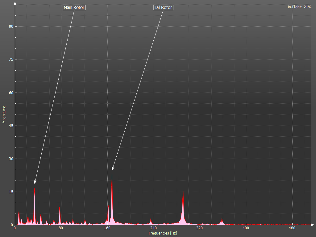

As for vibration graph, here it is, made on hard floor with tails blades on, main baldes off. I have to say I didn't try 3.1 on this heli yet, it is still on 2.8.
yufasa
Posts: 110
That looks fine to me. I don't think you would have any issues with vibration from I can see.
