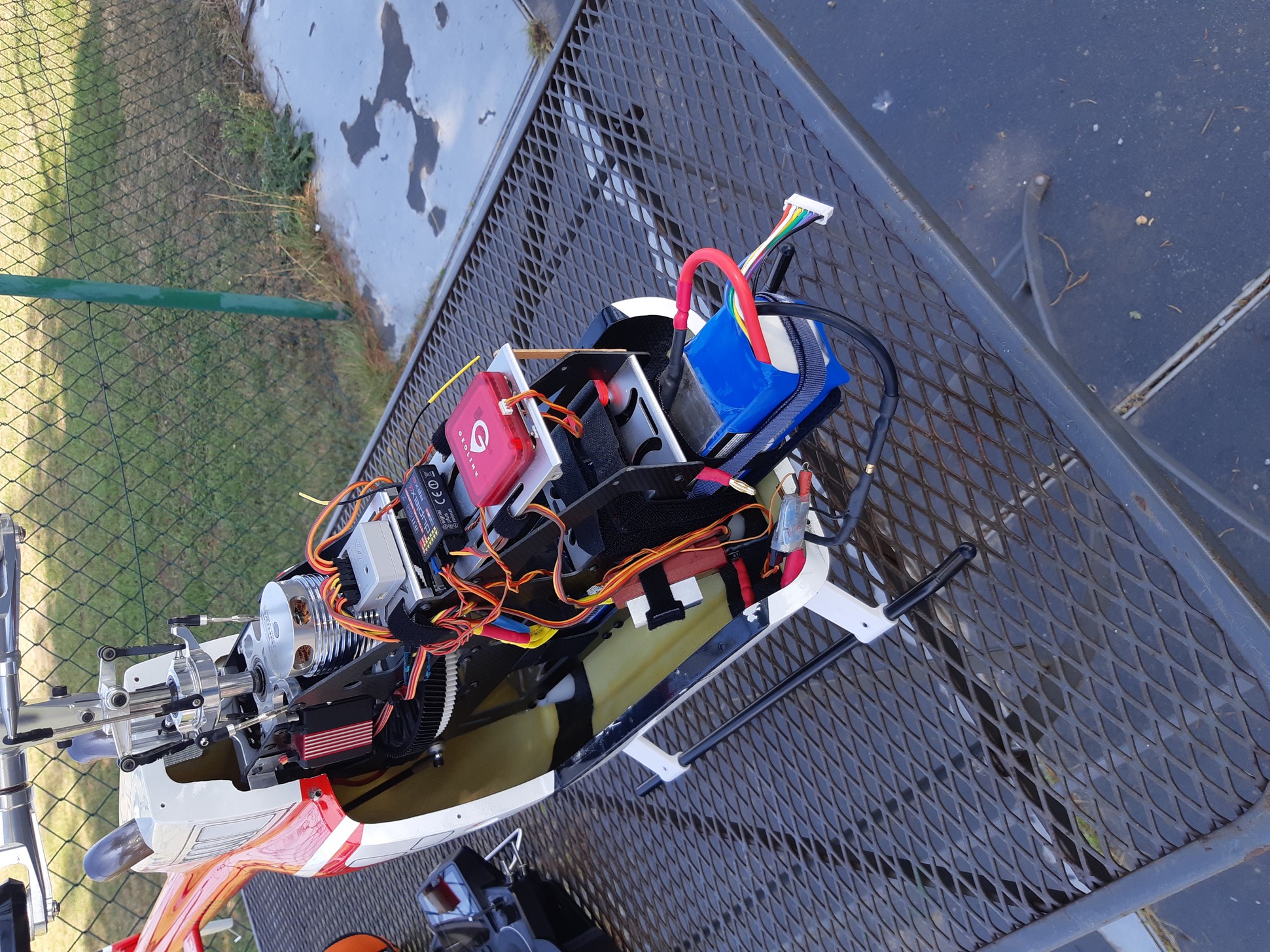

the original error no longer appeared. The reason was originally that the battery was below the geolink. In inverted flight, the battery covered the geolink. I suspect that the GPS connection was interrupted when I flew on my back for several minutes and thereby turned the helicopter into the normal flight position.
Posts: 12929
unfortunately also this mounting position is not ideal. It should be mounted ideally at no conductive part. And from other side there should be direct visibility. So upside down positioning system could not work perfectly.
