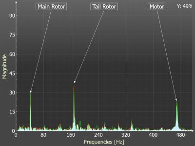

I investigated the high tail vibrations and found the torque drive tube was bent (!). This is embarrassing, as it's the only heli I bought used and I thought I'd checked it over thoroughly....... ;) It looked like the tube had been 'straightened', maybe more than once, as it had a couple of bends. Now I've replaced it with new + bearing and the vibration plot looks much better - see here: (Y axis).
I hope this fixes the problem but it will be a few days before I can test fly.

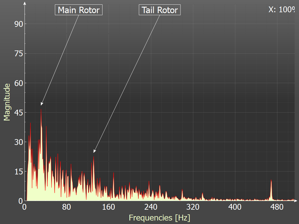

Looking at the vibration plot for the other axes it looks like I have a problem for the X axis as it's reporting 100% vibrations, see here:
This vibration seems to cover a wide range of frequencies, unlike the other axes where 'peaks' show clearly where (e.g.) main rotor or tail rotor issues are. Of course I can systematically remove parts of the head / swashplate, etc. and re-test, but I've already made sure the main shaft is straight (in the lathe with a dial test indicator).
Can anyone who's familiar with these vibration plots provide any guidance, please? With the tail (Y axis), it was an obvious 'fix' but with this X axis plot, I don't know where to start!

Regarding X axis it is not looking normally. From the plot it look like the unit itself is not holding firmly.
Could you please verify that the electronics in the aluminium enclosure is holding well?
It should be enough to hold (connected) servo connectors and try to move with them to a side (wiggle). There must be zero play.
Or is there something that is bouncing to the unit?
This could develop such strange vibrations.

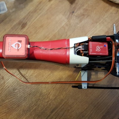

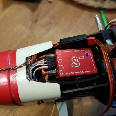

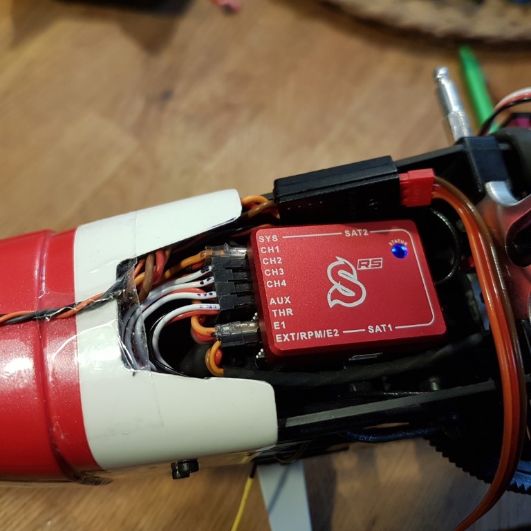

Thanks, Tomas for your quick and helpful reply. When I checked the unit as you suggested I noticed that the Y connector I fitted to the SYS port (to make it easier to connect the USB cable) may have been vibrating against the case - see pictures.
I wouldn't have thought this could be an issue but after your guidance can now see why it might! I moved the connector and yes, the X axis vibration plot is much lower - around 40 maximum. I had flown with this connector in-place, loose next to the unit. In future I will remove the connector and hopefully the problem is solved. I will report back when I have test-flown. Again, many thanks for your help on this.

If you will redo mounting I highly recommend to not bend antennas too much.
From provided photo it looks like it is not ideal. Antenna lifetime and performance might be improved if bending radius will be over 3cm.
