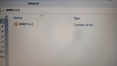

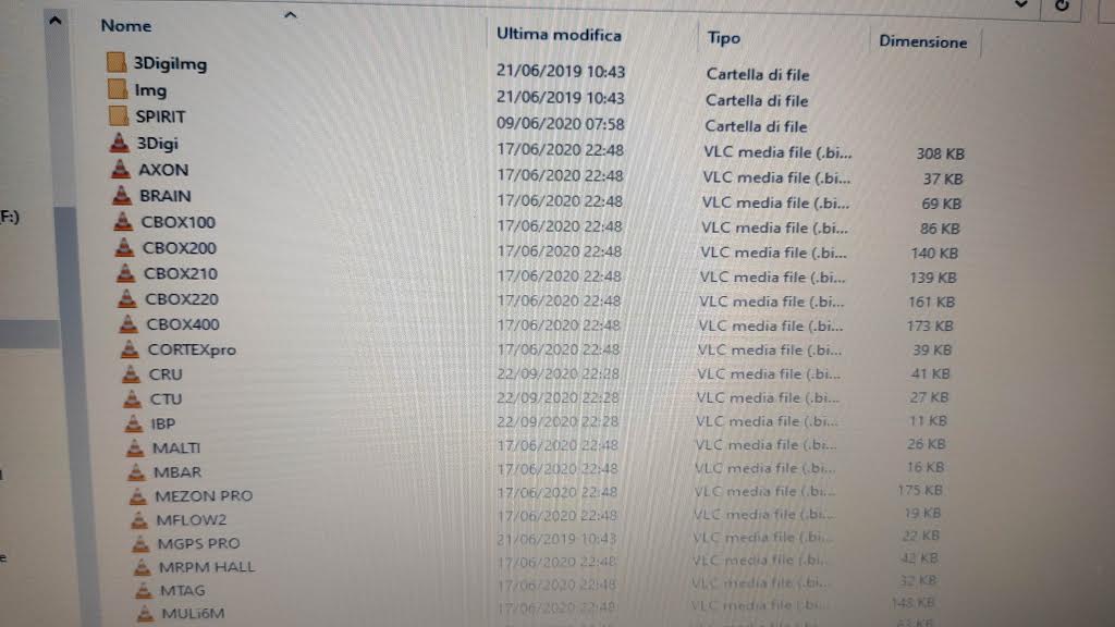

if someone has updated the DS 12 to v3-2-0 can you tell me how to do it?
Thank you
Posts: 12988
marcothefly
Posts: 12
Joined: Mon 24. Aug 2015 13:59:00

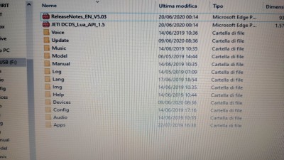

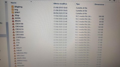

Thanks Tomas, but I didn't quite understand where to copy the SPIRIT-3-2 file.
Sorry :)
Posts: 12988
Old files must be replaced with new files.
So you can see there are 3 things in the SPIRIT-3-2/Devices directory. These must be copied to current Devices directory at your SD card as written in the guide.
