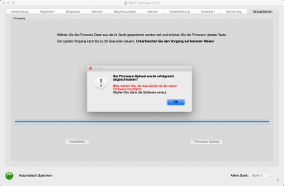

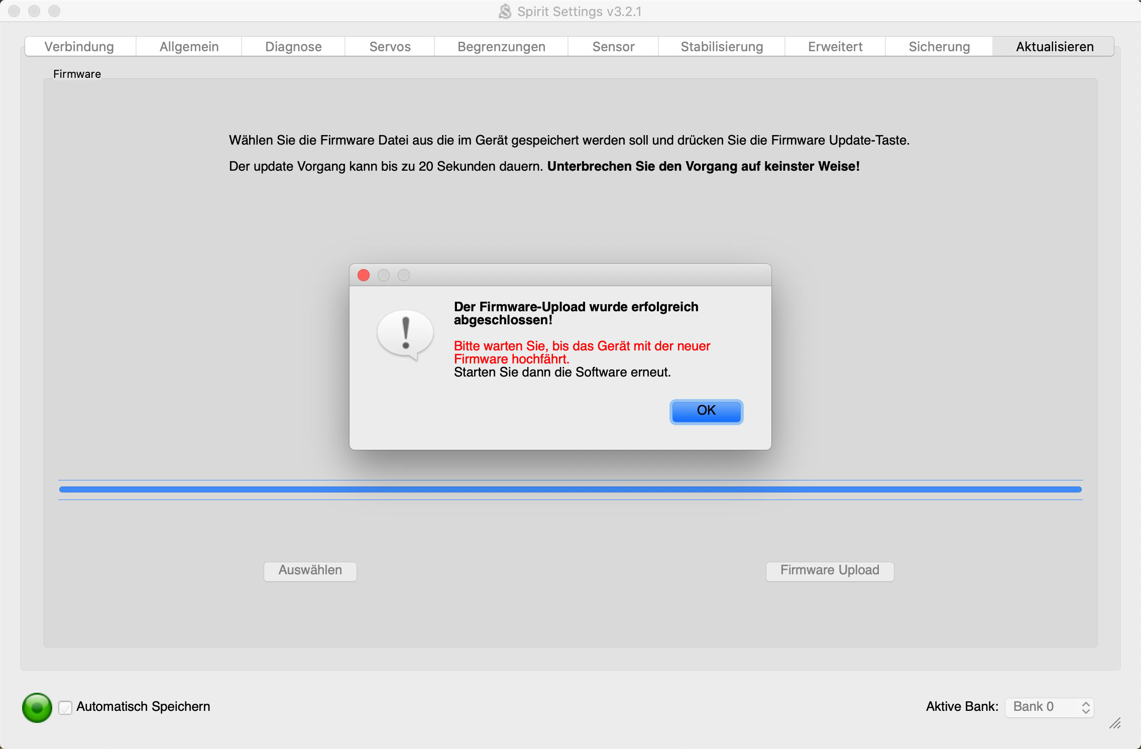

ZeXx86 wrote:Hello,
wow, that is great! Good job.
I am sure it can help others.
So the flashing is working well now?
YES, sir ;)
the proof :)
the proof :)
