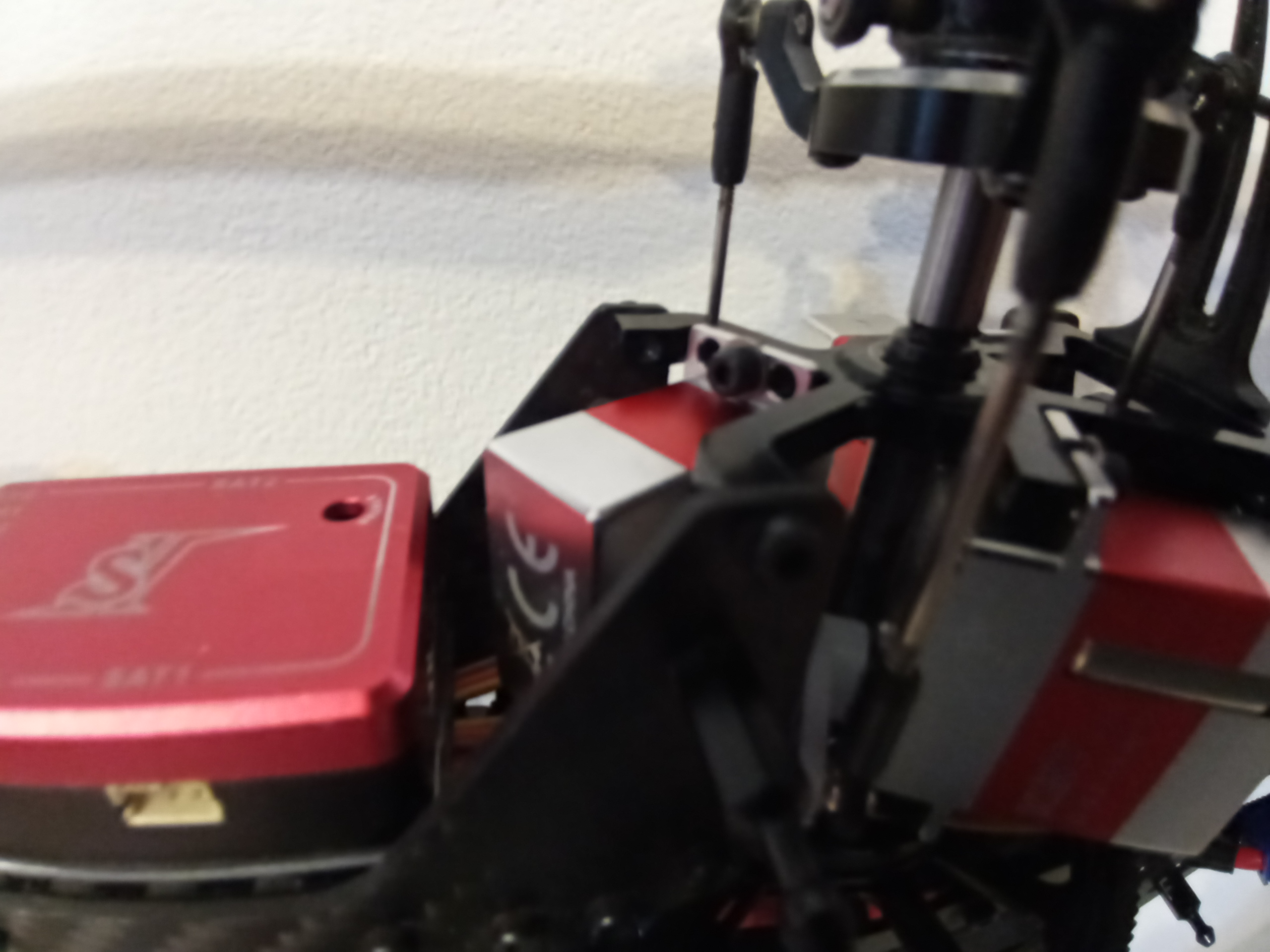

Could servo thats mounted really close to the unit cause any distraction to sensors in the unit?
That is one thing that i have actually changed recently - cyclic servos. I was using Emax ES09MD before, and switched to KST DS215 V3 like 100 flights ago...increasing magnetism? Just a thought..
As for pure flight performance - it got better, cyclic steering is noticeably smoother now with KSTs.

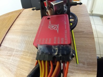

- adding some hot-glue on top of servo/ESC/RX connectors (see picture attached) - to make them even more secured, as Tomas suggested that anything insecure can cause trouble...so i thought better too much then too little.

So it looks like the hot-glue on connectors solved the issue :mrgreen: :mrgreen: ...but I hardly believe that...kind of a witch-craft. I really hoped Extended signal processing was the cure for a problem, but now it doesn't look like it..
