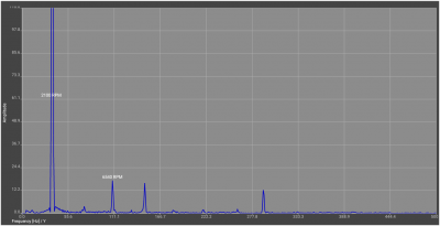

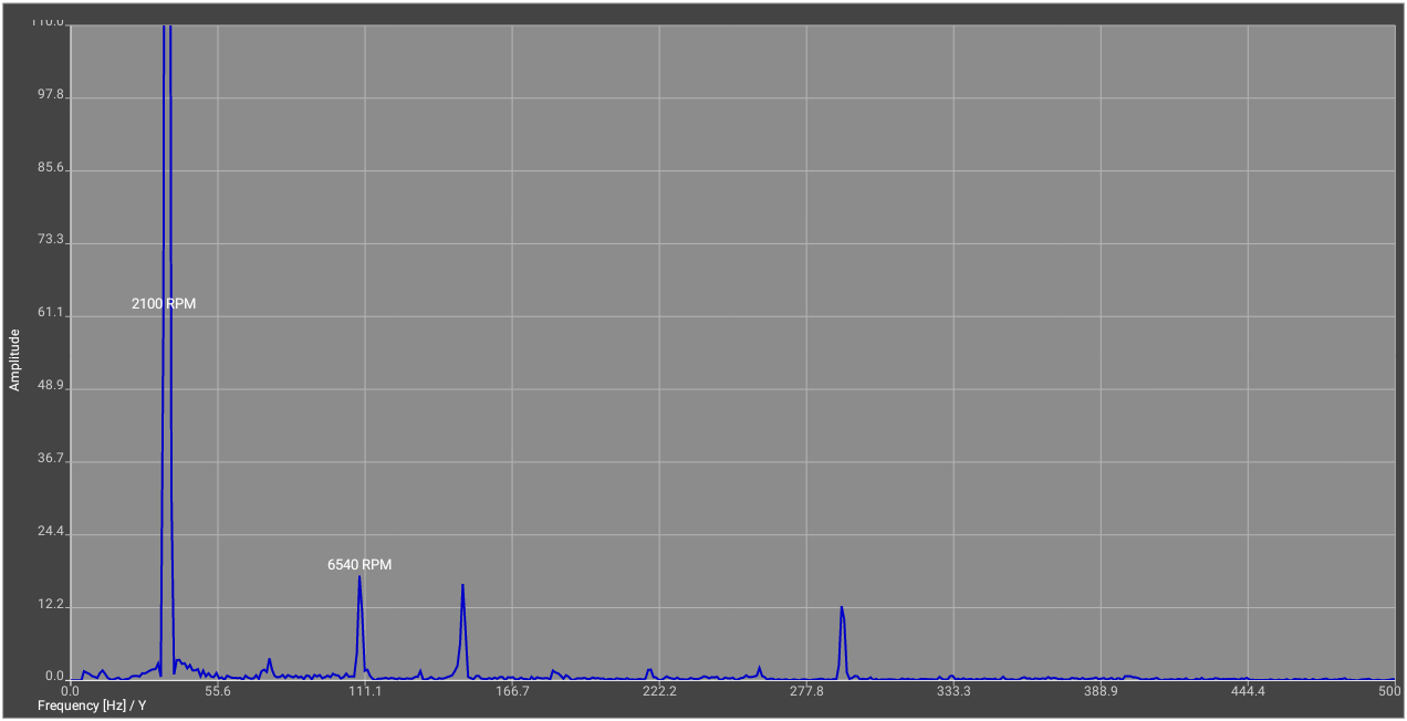

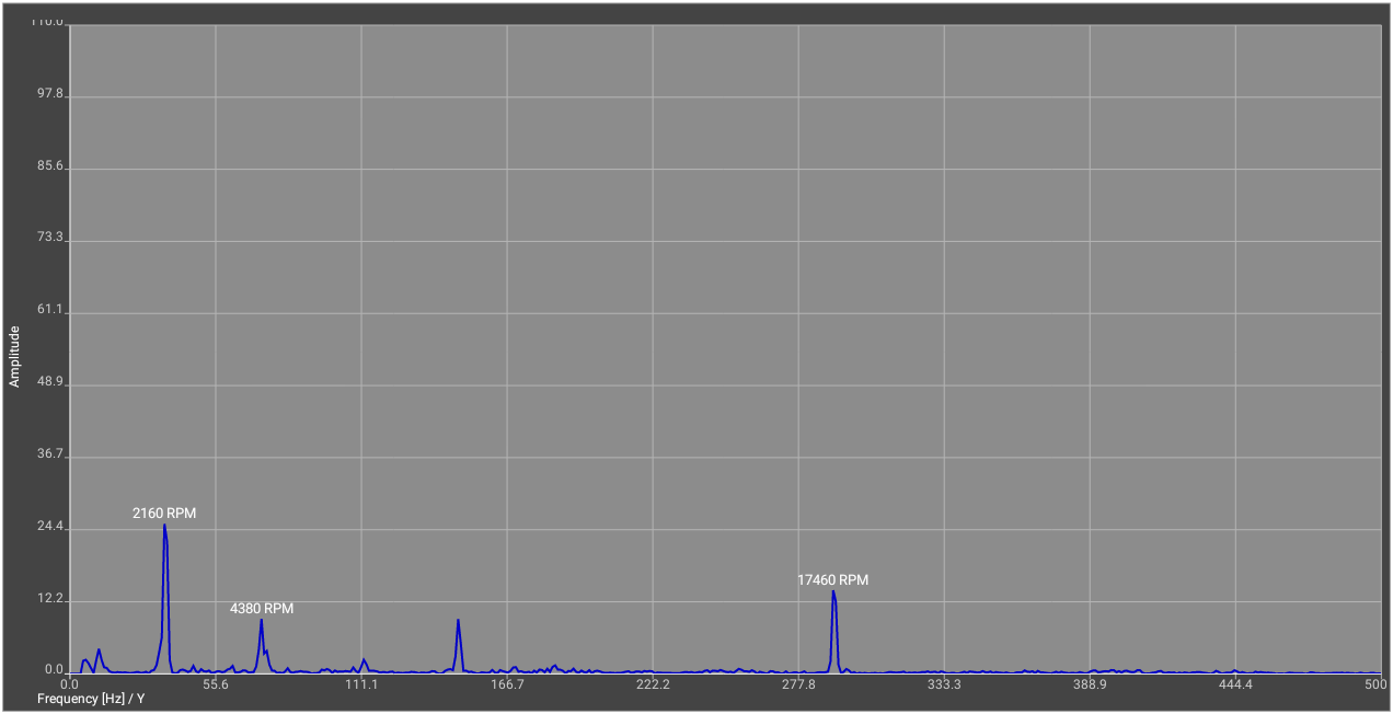

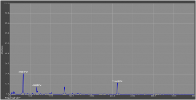

John Clayton
johncclayton
Posts: 66
Joined: Tue 10. Feb 2015 15:26:35
I now have reasonably clean X/Y/Z vibe analysis with main blades on.
I have not yet tested the X5 in flight, but will do so in the coming week.
To get this, I simply tightened the feathering shaft as much as I could, basically to the point where I thought the strength being used would soon strip the bolts, or tools. This reduced the play significantly.
I attached appropriate commented images showing the difference.
I'll keep you posted as to progress.
after tightening the feathering shaft
before tightening
before tightening
