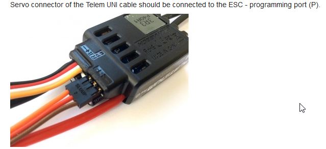

Amal, I have mine wired with uni cable between the esc and spirit sat port . I also have the telemetry wired between Rx Telemetry port and spirit system port for integration .
The esc yellow wire is not connected at all as I thought this was only needed to use the Spirit governor

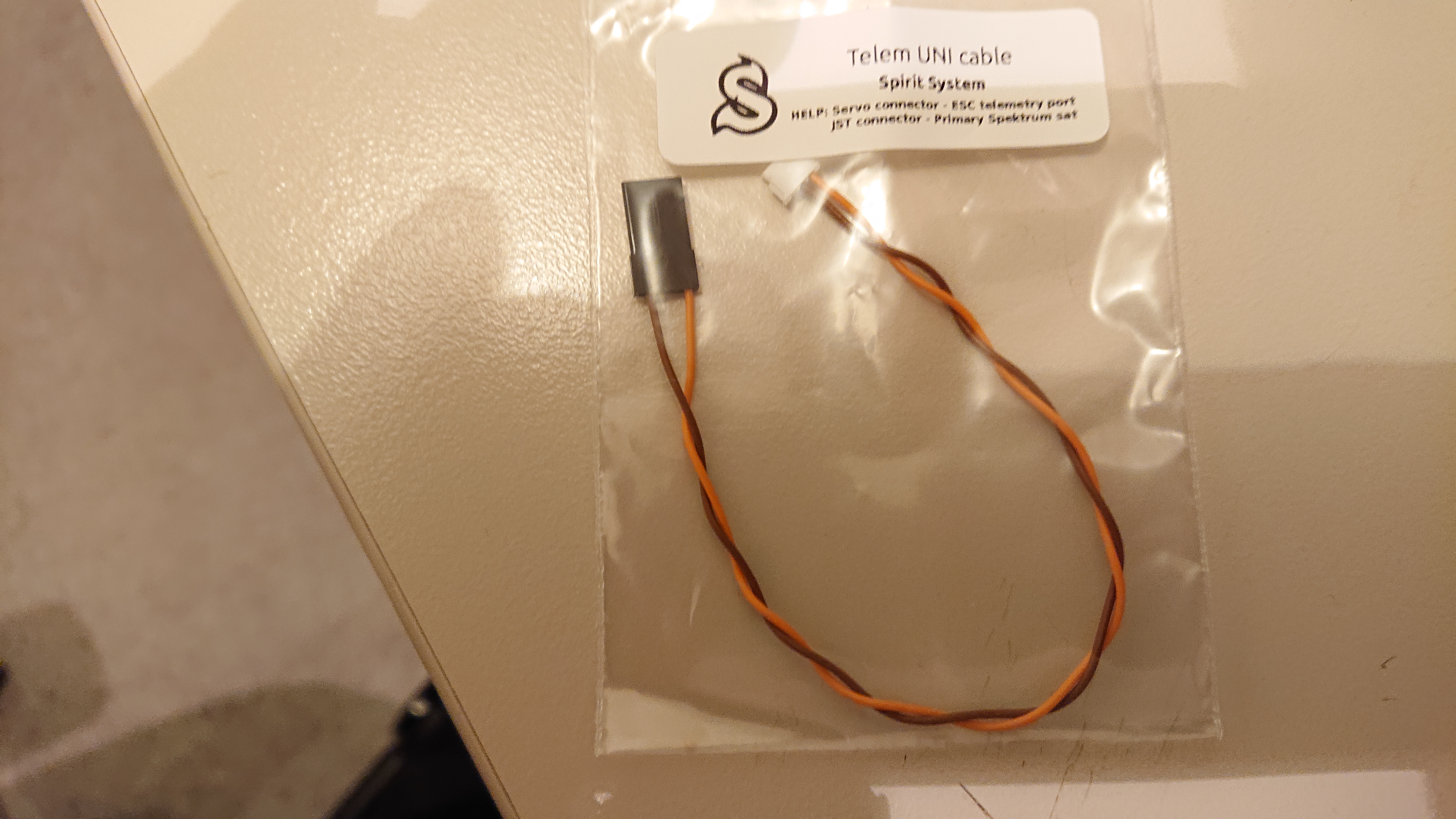

By the way, could you describe the connection wire sequence of UNI cable, on both ends. I am thinking to make a temporary cable and try. I had seen on several places Mr.Tomas commented that just removing the RED wire between ESC programming and SAT1 cable shall do the job. I just want to be sure. Mr.Tomas didn't answer my question regarding the self-made UNI cable yet.

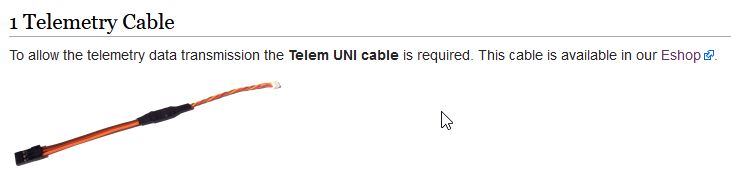

Posts: 12988
You can create Telem UNI cable easily with JST connector and servo cable. Only signal and ground wires must be connected, otherwise ESC or Spirit unit can be damaged.
Yes, Telem CC must be disconnected actually. It will not work with this cable at all.
RPM wire can be connected, but if you are not using Spirit Governor, then RPM from telemetry is fine. So all data will be transmitted including RPM over the Telem UNI.

Mr.Tomas,
Thank you very much for the clarification. Does it look like as the attached photograph? I just found it from another member's post. If so I can easily make it.
Regards,
Amal
Posts: 12988
Yes, this is latest version of the Telem UNI cable.
