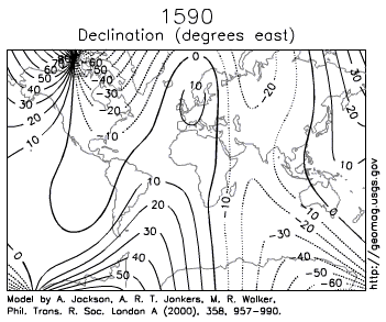

you will be surprised how much can change the earth magnetic field by few km
if you look at charts showing isogonic lines following magnetic declination
btw magnetic field don't change only when you move
but also as the time go by

urgno wrote:Dr.Fleming

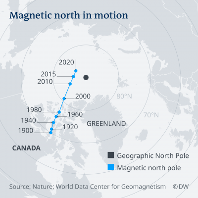

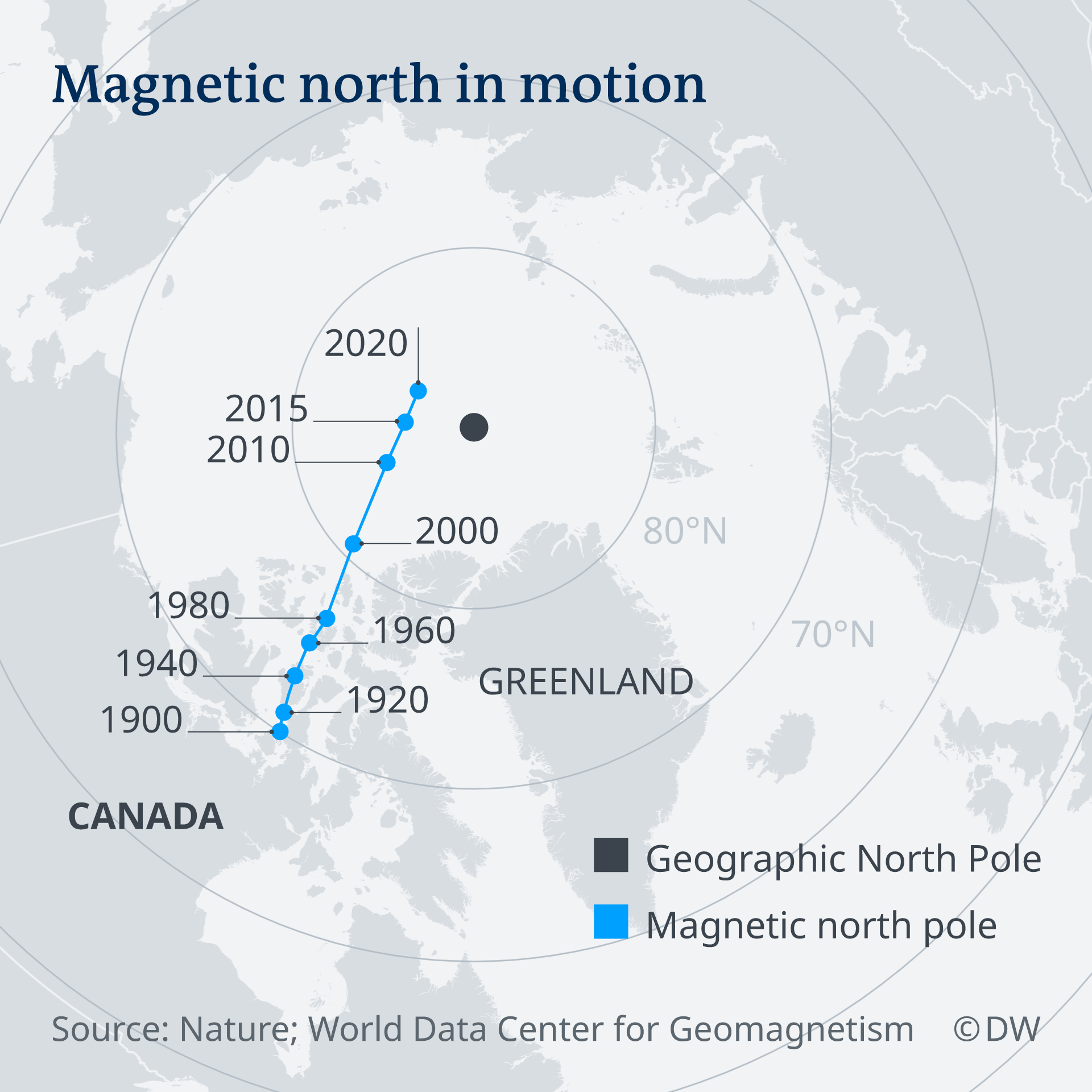

urgno
Posts: 274
earth magnetic field is constantly moving
magnetic north and south pole make no exception
west and east are only a geographical convention
there are no west and east magnetic poles ;-)
