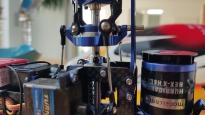

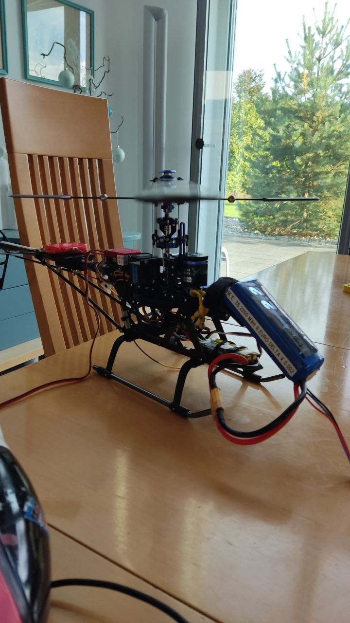

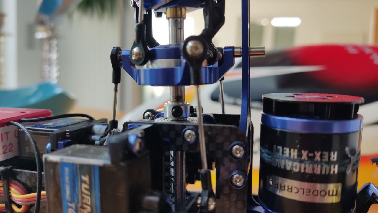

Hi Tomas,
as you advised i checked the settings in the subtrim menu. With engaged subtrim Swashplate is leveled. 0 degrees between the blades and all servo arms at the center.
Please see the pictures
Swashplate leveled
Swashplate leveled
Blades at 0 degree on pitch stick in the middle
Today i did another check flight. It's still the same problem. Position hold is ok. Auto Landing is way to fast down movement. RTH does not reach the return height as set in the settings tab. Should be 8 m. Rapid down movement by switching RTH.
