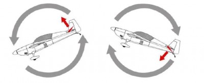

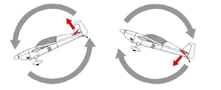

Hi Habásek,
Yes the image is from the top. Here the model is standing on its undercarriage.
H AndrewJohnHawes
I don't see anything wrong with the setup.
Please focus on the Diagnostics tab to see if the green slider moves in line with the elevator control lever (regardless of how the control surface on the aircraft moves) :
If not, reverse the channel in the transmitter.
If yes, check whether the control panel on the plane moves correctly, if not, check in the SW in the Servo/Reverse tab.
Do you still have the stabi function set up, is the function turned off when setting it up?
Harder to recognize the correct compensation movement is to have Head Lock on with more % gain, the movement is more noticeable.

Hi Habásek,
Yes, as I pull back on the elevator stick (to pitch up) the green bar moves towards the top and vise versa towards the bottom when I push forward to pitch down. The control surface moves correctly when I do this. However, when I check compensation movement, when I till nose of aircraft down, the compensation movement is for the elevator to move down to INCREASE the severity of the dive!!
This action is very clear to see at the moment.
Because I had this GTR previously on a helicopter (where it worked correctly) I have reset back to factory settings previously, just in case, as well as obviously having the Aero firmware loaded.
Sorry!
Andy
Sorry!
Andy
