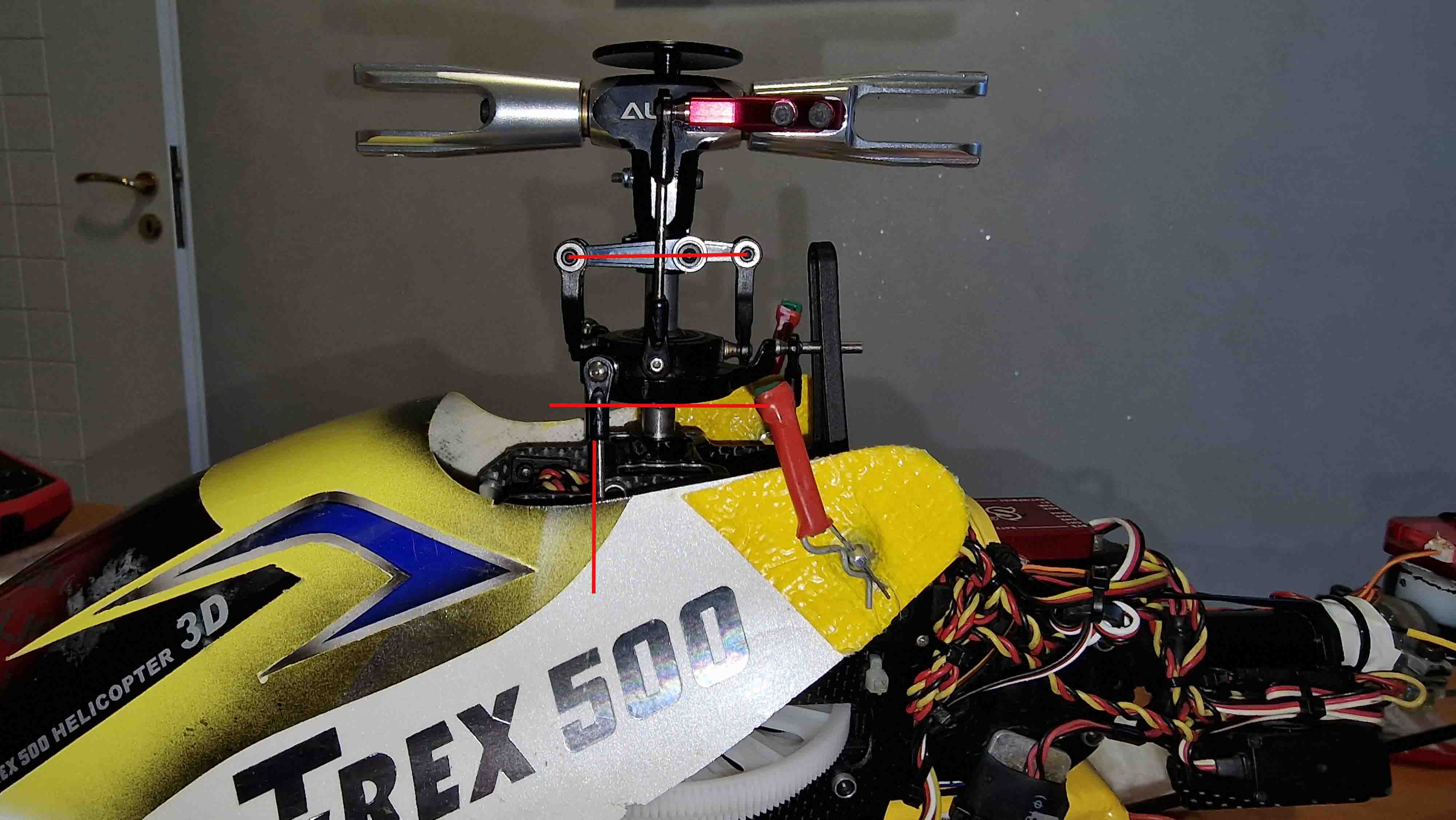

it's not set up right , the servo horn are not straight.
I can tell you step by step how to do it, but I think these are things you already know.
Why elevator is it so inclined?
the other two servants are not at 90, but slightly down.
swashplate not is level.
and I believe that the tail it is not set well, you have too much subtrim (but that has nothing to do with your problem, it's another thing)

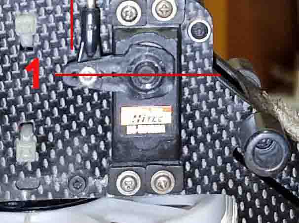

this is servo 90°

do these things:
servo-subtrim tuning
move slider ch 1 2 3 to have this
https://www.spirit-system.com/phpBB3/do ... d=4827&t=1
with the servant in this mode you must have this (follow the red lines)
this situation you must have it turning the rotor 360 degrees, always the same
and In the end you must have this situation

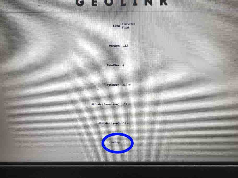

Thank you i will recheck my setup. I do find with the 450 pro getting the servo exactly 90° by eye difficult. Is there a trick or tool to get it 100% correct.
I have run calibration for the geolink compass but with my heli at north on the hand held compass the geolink is stating 84°
Is there a certain tolerance? I can manually adjust in settings but only by +-45°
Can the compass calibration be done wrong or is it pretty fool proof?

Posts: 12988
84° is still acceptable, so it should be OK.
Calibration can't be done entirely wrong, but it could be done more precisely by moving to angles where LED light is flashing more frequently - with more gentle movement around to make sure GeoLink's LED will not flash anymore there.
If you will use 6° degrees correction then it will be perfect very likely. However it is easy to see with Position Hold. If model will be really steady then calibration is good.

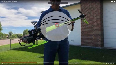

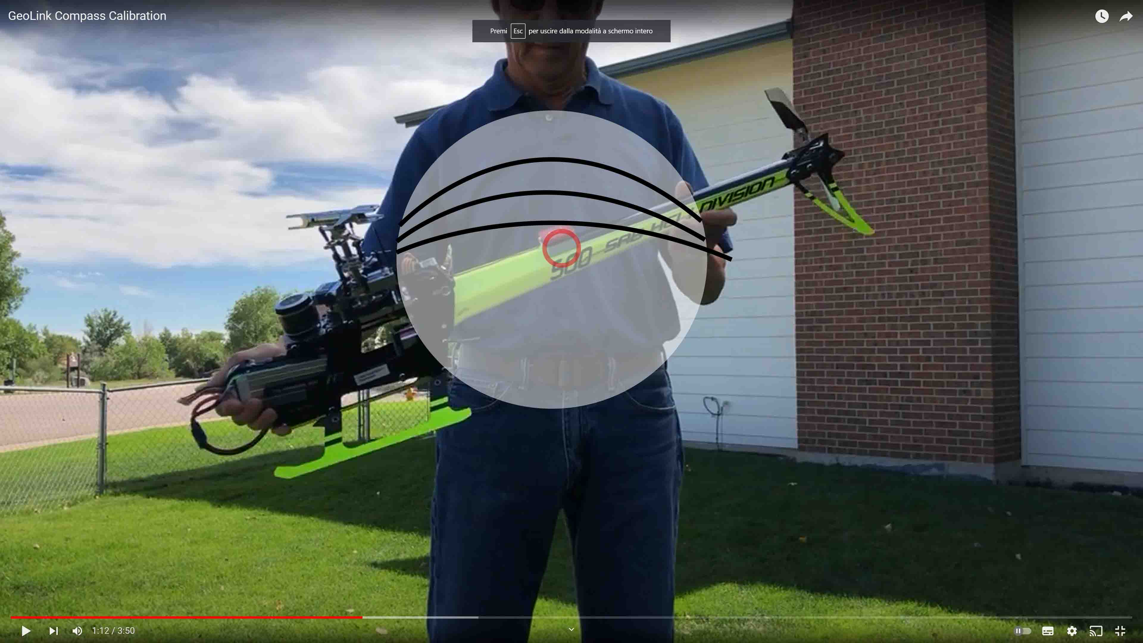

when I calibrated the compass I had some doubts.
When I made a tight movement I noticed the light changing
and then after I widened the movement.
But then I arrived at a certain point where the calibration never ended.
And it took me a long time.
I believe that I didn't understand good 100% all circular movements to do.
How the black lines of the circle of this image (I only made one to get the idea)
I move making a small circle how la prima linea nera, after movement how the second black line ecc ecc.
But then never finished calibration.
Exactly to complete compass calibration all the movements to do Which ones are they?
i remember i was at least 20 minutes when instead it had to be completed in a few minutes
