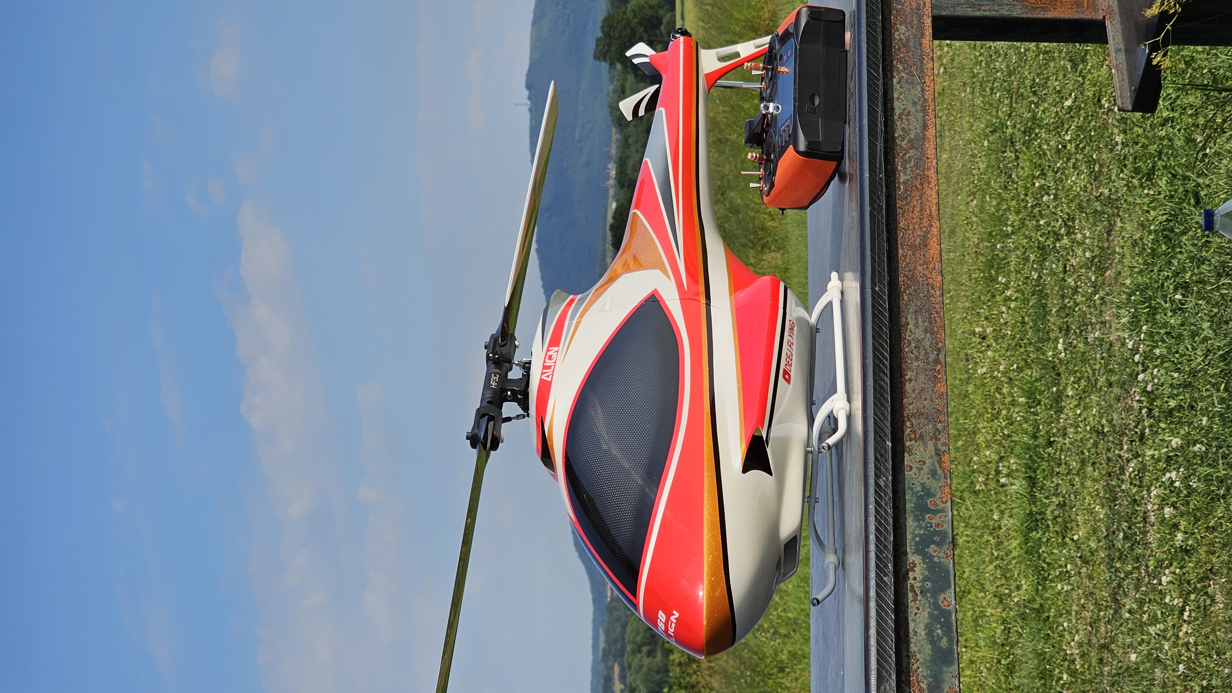

Yes I have 3 spirit GeoLink in my armoury, 1 is a V2 and the other 2 are V1,
I went out last night and tested the other 2 on my other helis so will check shirtly for stored date from the flight's
Issue is with this one it's a faff getting the geo link out of the body as tail has to come apart
