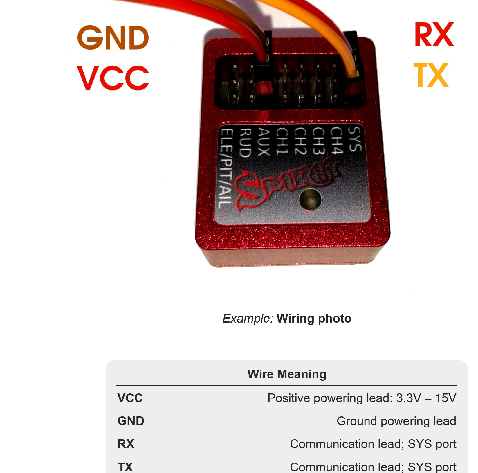

I think the shown wire harness is wrong. The sysport plug schould have only two wires not three.

Hi
Just look at the wifi module plug. You have only two wires plugged into the middle and lower position if you connect it to the spirit. In your harnes they are connected into the higher and middle position because you added the gnd. Leaf the original plug like it was just add the gnd from the battery to one of the other places like the Aux2 or ch0.

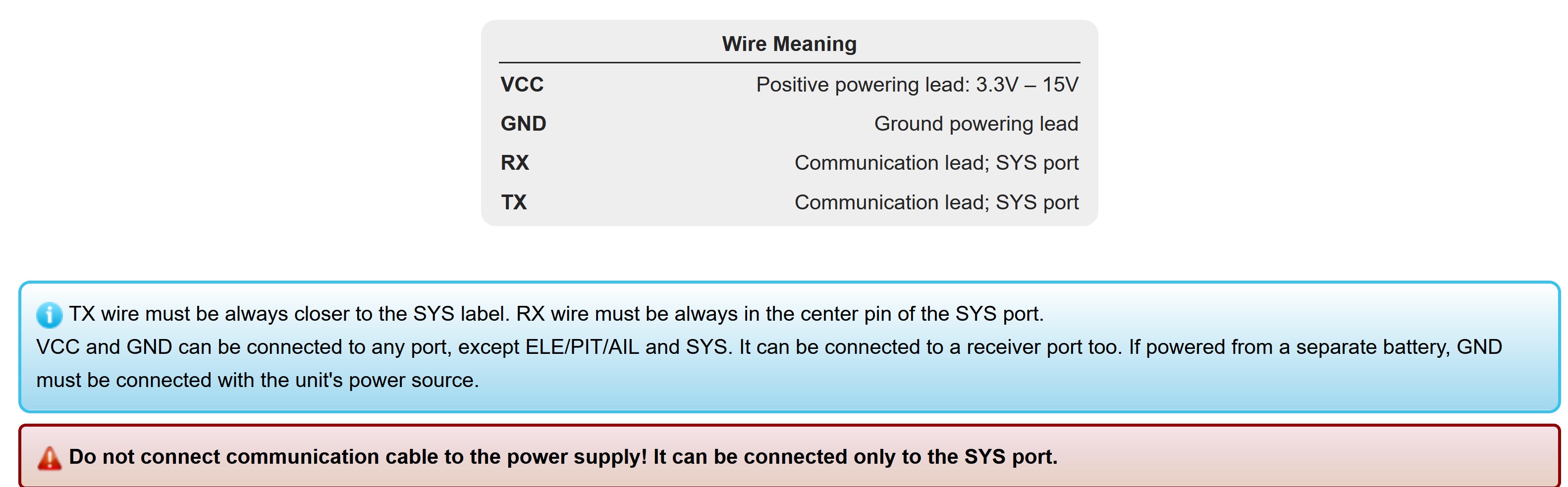

I think you can not use the GND from the Sys-Port as you see here -

Sorry my mistake. I saw the to wires and thought it would be the same like in my HOTT integration. There i use only the low two pins.

Mattes61 wrote:I think you can not use the GND from the Sys-Port as you see here -
I think it's not about using ground from SYS port, but of connecting WiFi-Link and Sprit unit grounds together. If WiFi-Link is powered from the unit or BEC, it happens naturally. But as I power it from a 2s Lipo, they need to be connected together. That's how I understand it (or wrong?).
