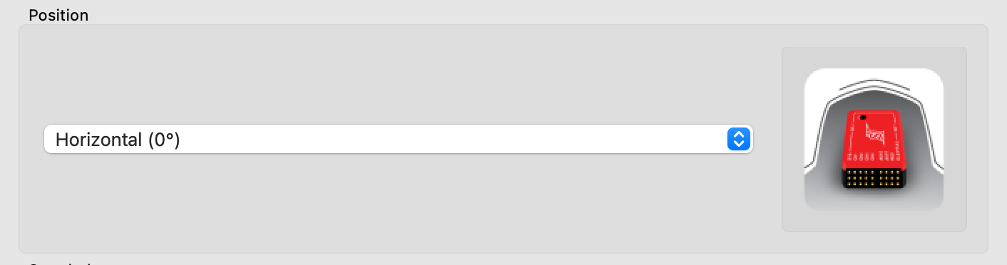

doingmainestuff wrote:....and the unit sits with the connector facing forward. My Spirit GT also faces forward (0* in settings). ...
"GT also faces forward": does that mean that the connector of the GT is facing forward too?
Zero degrees, as it's called in the settings. Which means connectors facing rearward. But, to me, that means the unit itself is facing forward as most FBL units are oriented this way.
