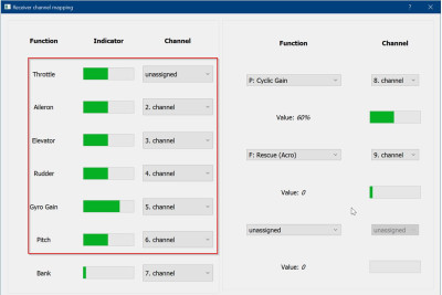

the channel mapping in Spirit GT is defined as follows:
Function......Channel (Jeti)
Throttle ..... CH5
Aileron ...... CH2
Elevator .... CH3
Rudder ...... CH4
Gyro Gain... CH6
Pitch .......... CH1
to my understanding, the functions/channels are now assigned 1:1 between Jeti and Spirit. the same function/channel in Jeti and in Spirit.
but unfortunately this does not work correctly, because on the one hand the channels in Spirit are different and also the values are not always -/+100%!

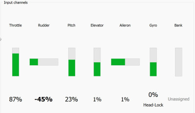

the Jeti and Spirit Input Channels have the following values:
Channel.....Jeti [%].....Spirit [%]
Throttle.......-105%........87%
Rudder........0%............-45%
Pitch...........0%............-20%
Elevator.......0%............0%
Aileron........0%............0%
Gyro...........0%............0%
and the channel assignment isn't 1:1!!!!
Spirit Channel.....Jeti Channel
Throttle.............no Action............+87%
Rudder..............CH5 Throttle........-45% / +118%
Pitch.................CH1 Pitch..........-118% / +80%
Elevator.............CH3 Elevator.....-100% / +100%
Aileron..............CH2 Aileron.......-100% / +100%
Gyro.................CH4 Yaw.............-87% / +87%
die Jeti Channel Outputs sind immer -100% / +100%.
this means that the Spirit Channel CH1 Throttle does not react to any Jeti Channel.
and the Spirit Channel Rudder CH4 reacts to the Jeti Channel CH5 Throttle, and so on.
this means that the Spirit Channel CH1 Throttle does not react to any Jeti Channel. the Spirit Channel Rudder CH4 reacts to the Jeti Channel CH5 Throttle, and so on.
this is what i mean by the channel assignment is not 1:1 and the channel values are not 1:1?!

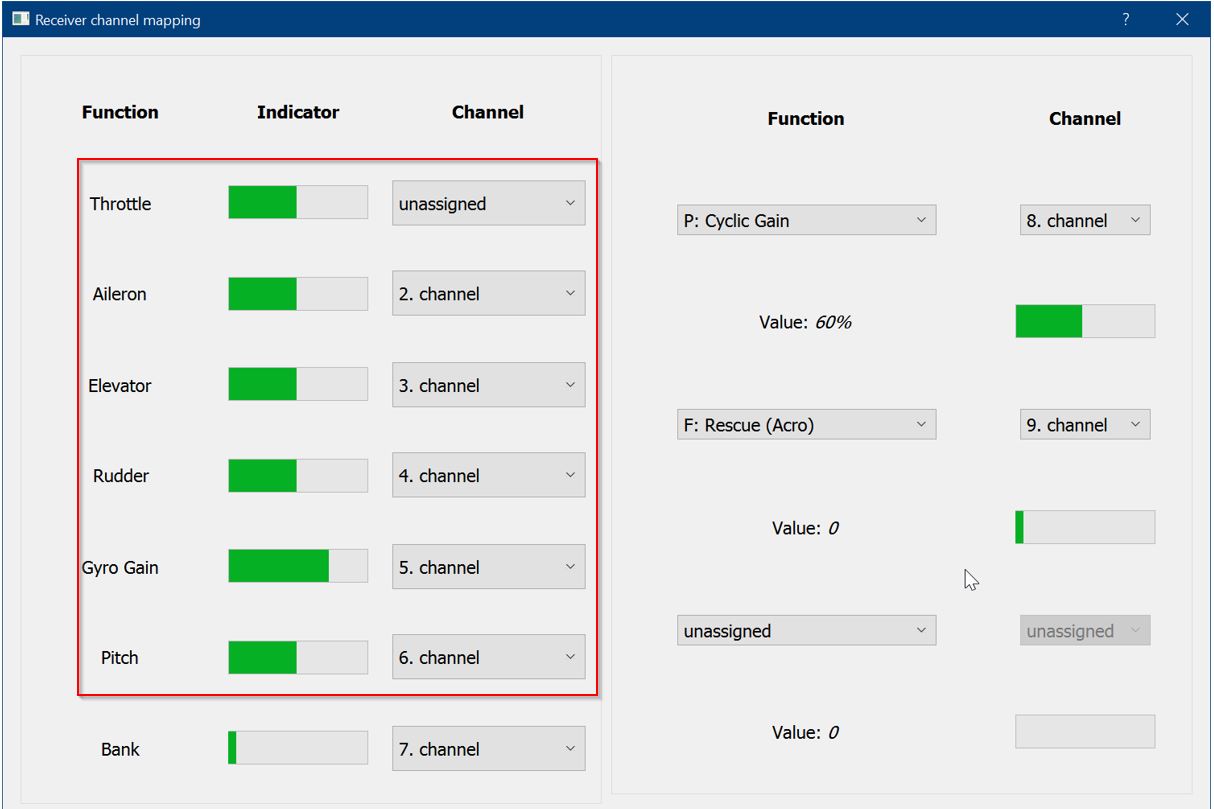

Posts: 13045
Your channel assignment is not correct.
In the Spirit unit, Throttle should be at Channel 1, Pitch at Channel 6.
In the radio:
Throttle ... Channel 1
Pitch ... Channel 4
As I said it is super easy to just create new model, set Heli to Spirit and it will work all correctly. Same at the Spirit side - you can leave all at default and it will simply work.
Or if you have so complicated setup in your current model then copy channel settings from newly created model to your original model.

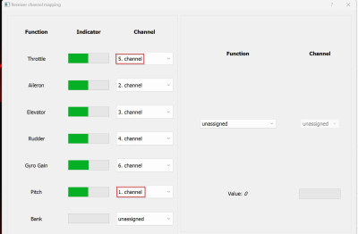

my goal:
I have various heli models with different FBLs on my Jeti transmitter. these heli models always have the same servo assignment. the FBLs used so far (miniTAGS, miniVStabi, CGY760, AXON) could always be adapted to the existing Jeti servo assignment by freely defining the channel assignment in the FBL.
I wanted to do the same with the Spirit GT, but as I described above, this doesn't seem to work, as Spirit presets the 6 channel assignments CH1, CH2, ..., CH6.
and as already mentioned, I find this Jeti integration proprietary and not the right philosophy for a very individually programmable Jeti transmitter.
the only way is to adapt the channel assignment in the Jeti transmitter to the specifications of Spirit:
Jeti Servo Assignment
S1 Throttle
S2 ◄ Roll
S3 ▼ Nick
S4 ► Pitch
S5 ▼ Yaw
S6 Gyro Tail
now i'm curious to see what surprises await me in the further setup ;)
johann
