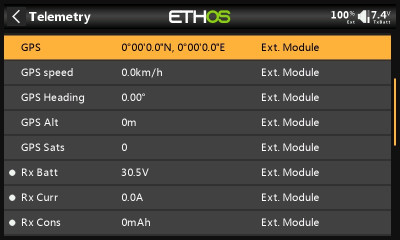

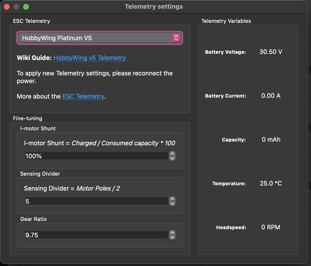

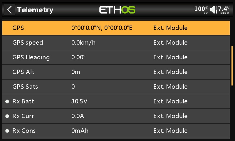

Hey there, I am actually experiencing the very same thing, however I am running the latest (3.7.1) firmware. I am sure I am doing something wrong setup-wise but am out of things to try.
I can confirm that I see valid data for RPM and battery voltage from the ESC when using the desktop app connected via USB, but am not seeing RPM when scanning for telemetry. I do see battery voltage and current however.
My setup:
Frsky x20s - Ethos 1.5.19
BetaFPV SuperG Nano Elrs transmitter (flashed with 3.5.3) firmware
Spirit Ethos integration script 3.7.1
HobbyWing Platinum v5
SpritGT flashed with 3.7.1
Radiomaster RP3-H
Thanks!
