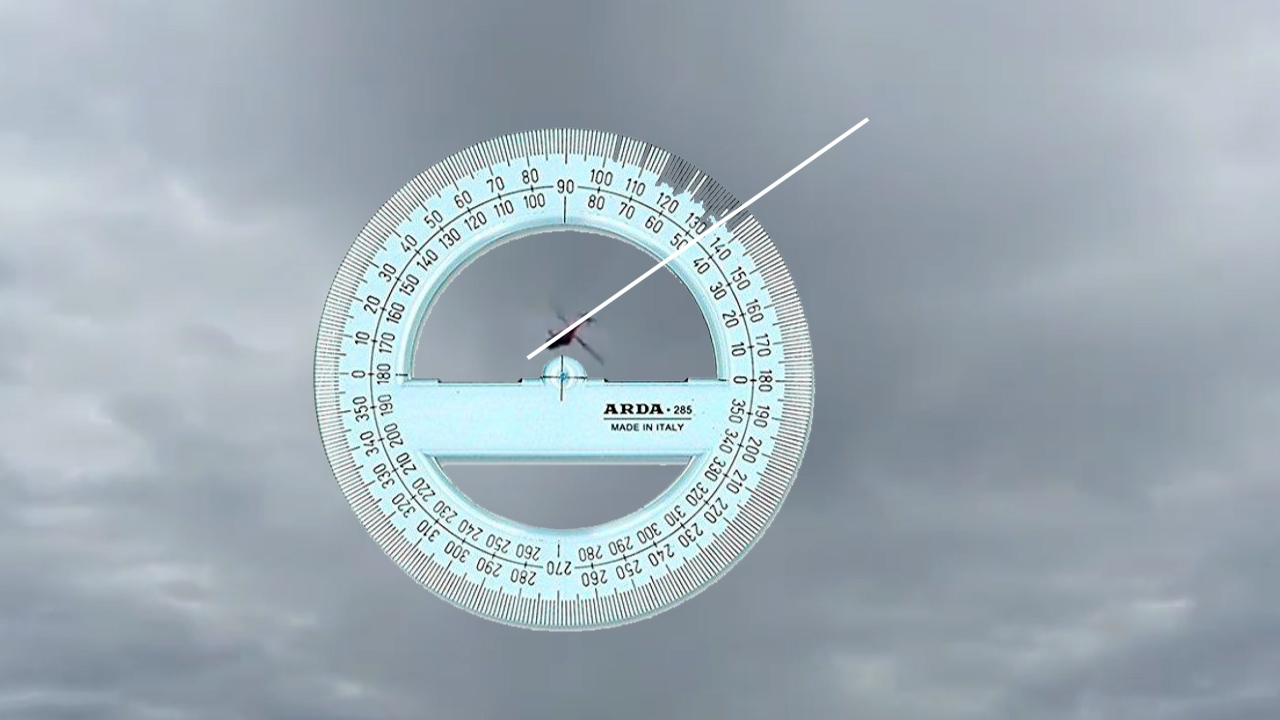

franz88
Posts: 340
I have a hypothesis
after flying and doing stunts
if helicopter is found only in a certain inclination the rescue fails.
how in this video (0.52 seconds)
https://www.youtube.com/watch?v=kBg9e6Z1XEg
see attached image
my hypothesis is this. (rescue normal)
If helicopter it has the blades towards the ground puts the blades towards the sky and after the helicopter goes high.
If the blades are pointed at the sky the helicopter goes high.
When the spirit understands if helicopter is inverted or if it is not reversed...when helicopter is tilted at 90 degrees(random number why i I don't know the degrees where it is at the limit between inverted flight and normal flight) maybe he can't understand if it is reversed or if it's normal.
For example in the video the helicopter it's reversed of aileron of about 45 degrees.
Maybe only when the helicopter it is tilted at 45 degrees problems are encountered.
My is one hypothesis.
Posts: 12887
franz88 wrote:I have a hypothesis
see attached image
Rescue algorithm works in a different way. You can read at the linked page you can make Rescue/Stabilisation very precise with Stabi Correction (it could help with very complex maneuvers). There are 3 different modes you can set. Each has different benefits. So please read the linked page.
