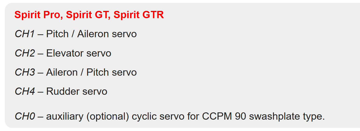

Can you explain how to connect the receiver to the Spirit GT and to the servo? A small drawing is also fine. Thanks
Posts: 630
look at spektrum website there are receivers with more outputs -
https://www.spektrumrc.com/aircraft-receivers/
Connect the receiver via SRLX2 to the Spirit GT -
I think some channels are busy by the Spirit FBL and can not be taken for other options that must you proof -
You can take for example the Spektrum AR10100T 10 Channel Receiver and take there the servo outputs you need -
For this your BEC must be very solid that you get no trouble with the voltage supply -
For adjusting some Settings in the FBL you can take channels that are not used by any servos connections etc. -

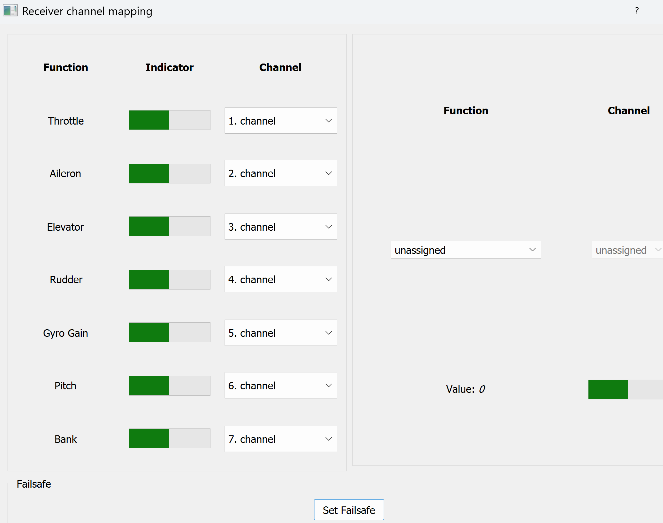

Posts: 10
Joined: Mon 29. Sep 2025 8:50:08

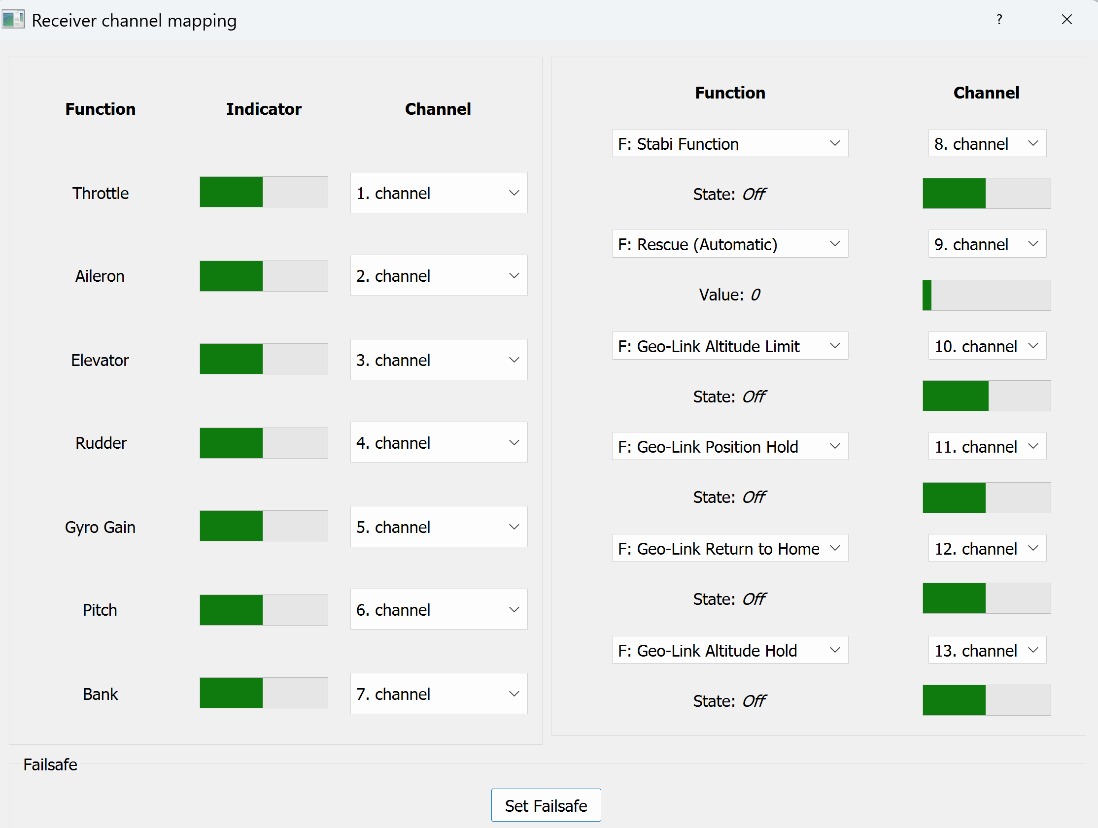

Thanks for replying, but do I still get all the Spirit features (return home, auto save, etc.)????
Posts: 630
its a question how many settings are possible in the Spirit - I think Tomas can help here -
With Spektrum you have 16 Channels available -
The funtions which need no Servo are possible up to 16 Channel minus the channels needed for controlling or switching functions -
If you need more Servooutputs you must buy another receiver with more outputs -
