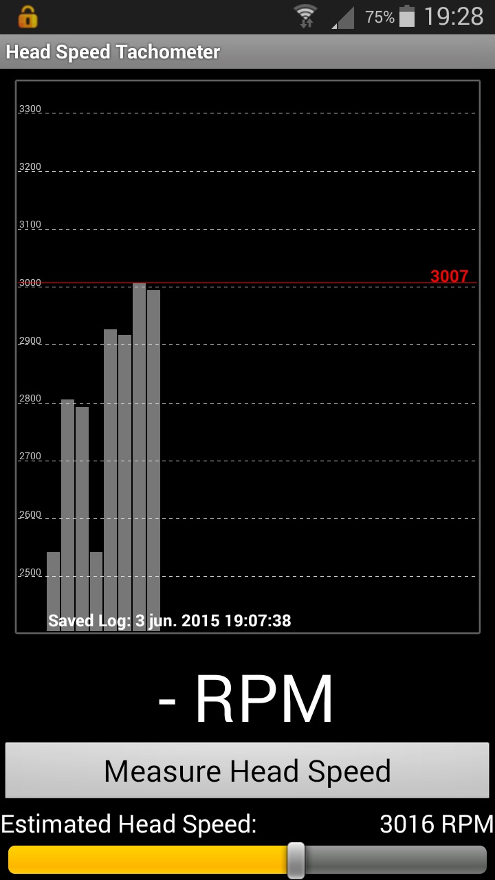

Oh, I typed in all the numbers on the governor page and set it for 3000 rpm.
I have to say, pretty damn accurate result. :D
Max. rpm is at 100% flat TC.
X3 tach.
X3 tach.
