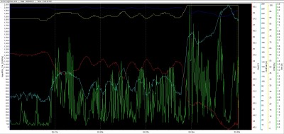

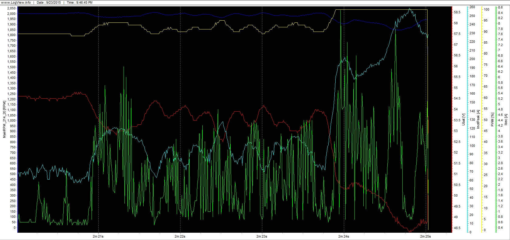

Problem re-occurred with a violent crash and burn. Thorough loss of my new Goblin 700 and the 14S Revo pack in it.
Replay of first two events. I activated hold immediately this time but did not regain control.
I reviewed all telemetry data from my DS-16, the Spirit log and the Kosmik log (amazing the SD card wasn’t melted). No errors. Nothing to even hint at an explanation of the event.
I completed tuning Spirit and the heli was flying great. Tail tuned perfect, cyclic exactly where I wanted it, rescue working perfect, done. Ready to fly it like I want to, hard.
Last seconds of flight before event, I was doing smooth piro tic-tocs, transitioning into hard aileron tic-tocs when the heli began un-commanded full + collective and full cyclic. Interesting that it was rotating back elevator to left aileron into the ground. It was not just locked into what I had told it last (left/right aileron with mild collective; not full). I hit hold the instant it was out of my control and did not get control back prior to impact like the previous two incidents. If I had been higher and had a little more time, I may have regained control like the previous 2 incidents. No way to save it without control... pretty scary really.
I have reviewed all telemetry data from my DS-16, the Spirit log and the Kosmik log (amazing the SD card wasn’t melted). Nothing to explain the event at all.
- There was no loss of signal between transmitter and receiver, or receiver and Spirit.
- Jeti: Signal quality was 100% at the beginning of the event.
- Spirit: no signal loss until during fire.
- Jeti telemetry highlites during event:
- PWM 100%
- Rx volts dropped to 7.74v
- A1=8, A2=8, Q=100%
- Spirit vibes maxed at 24% at moment of impact
- UBat dropped to 50.4v (3.6v/cell in 14S)
- IBEC amps was 2.5amps during event
- Temp BEC was 122f
- Temp FET was 111f
- REX failsafe was disabled
- REX port E2 connected to Spirit (EX Bus)
- REX port EXT connected to JLog 2.6GW (red wire removed)
So what is left that can possibly influence the flight in this manner (un-commanded full collective and cyclic)?
- Transmitter? I created a new model from scratch after the first two events. No problems with all my other helis.
- Receiver? This is a different REX7 than in the first 2 events. Unlikely 2 devices have same physical defect. Same firmware and it is v1.0. Some defect in firmware responsible?
- Spirit FBL? This Spirit is new and has only been used on this heli.
No errors in log to indicate any problems, but that isn’t really conclusive either.
I reset the Spirit and created a completely new setup from scratch after the first 2 events.
- Cyclic servos (BK8002HV)? If a servo mis-behaved, the Spirit would have tried to keep the disc stable. No way it would have allowed full cyclic with 1 servo going crazy.
- Power to system? Provided by 30amp Kosmik BEC from Master to Spirit and slave to REX. Complimented by TP250mah 2S lipo by 2 servo leads to REX servo ports functioning as backup and buffer. No evidence of any voltage fluctuations (high or low) from REX telemetry data or Kosmik log.
- Static hit? Continuity between tail and motor confirmed for first 2 events. Added an additional grounding wire between boom and frame after first 2 events. No possibility this was static related.
Out of this list of things that could possibly influence/cause this problem, there are only 2 things not eliminated.
- defect in REX firmware
- physical defect in Spirit FBL
New to me with this heli is the use of EX Bus and the configuration of the Spirit Jeti integration. I have UDI configured on all of my other helis.
Very frustrating to lose my heli so completely out of my control with all this data and no leads at all.
Ideas?
G700C final settings.4ds
(255 Bytes) Downloaded 293 times
spirit-log-2015-09-23-213250.pdf
(88.7 KiB) Downloaded 283 times
