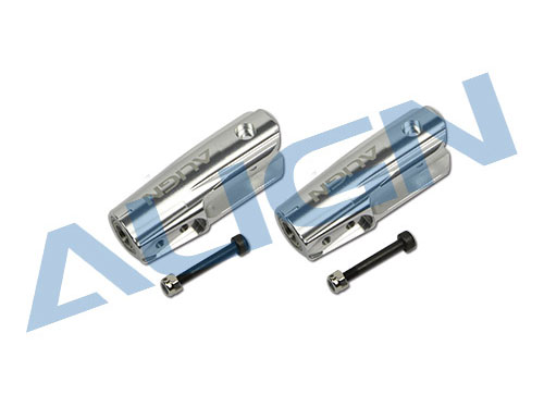

Metal main rotor holder they are impossible to find.
Your third site has the main rotor holder but not do you mail to Italy.
I found something in america.
that's why I left everything as it is now.
I only need this but they are not found

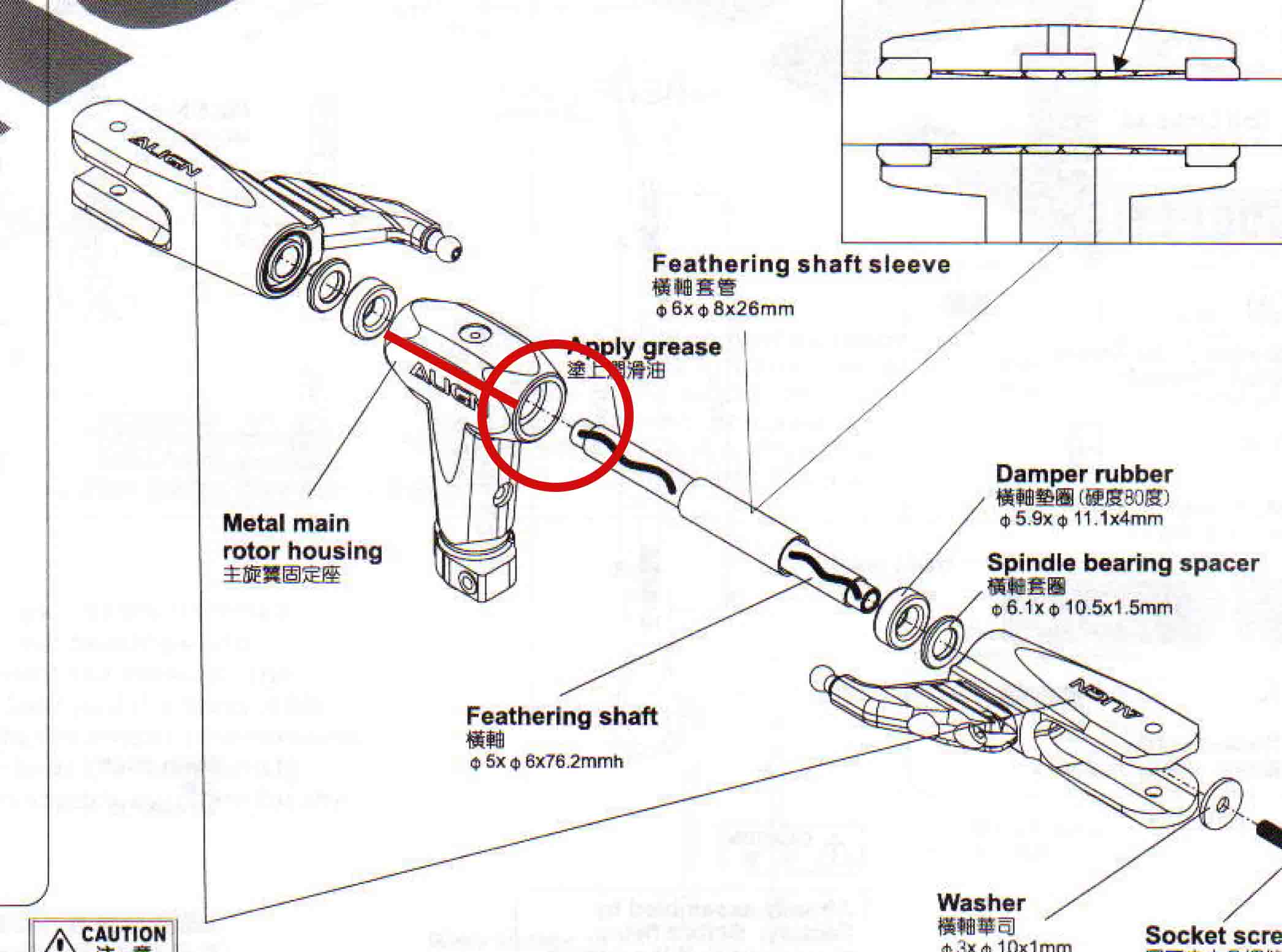

idea if i use metal main rotor holder trex 500x ?
all components are the right size same as t rex 500 efl (my t hub)
can you measure me the length of the t hub (the red line)
of your trex 500x
and the circumference measured with the caliper, internal internal (circle red)
500x I find them in Europe the components
trex 500l dominator is compatible equal
Posts: 643
Hello Franz,
I measured a length with ~34 mm -
Inner distance between the bladegrips is ~37 mm.
I can now roughly measure the outer diameter of the spacer, which is ~10 mm, since everything is assembled.
I hope this helps !
Matthias

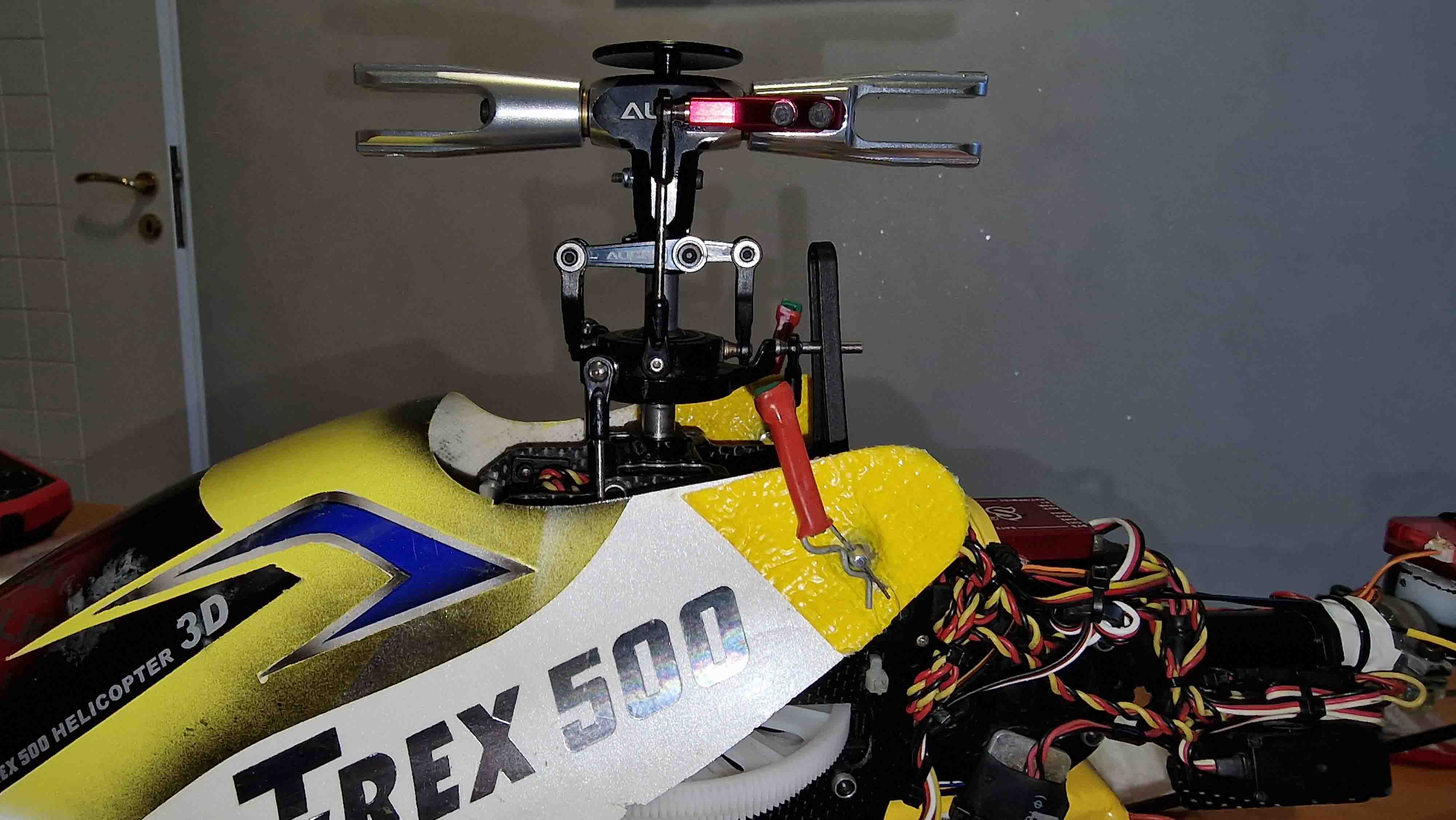

thanks, yes i checked everything and all components are the same.
My t hub is 34mm long so it's safe to mount
I bought these two pieces
and now I can use the swashplate with pitch normal and I hope they decrease the vibrations

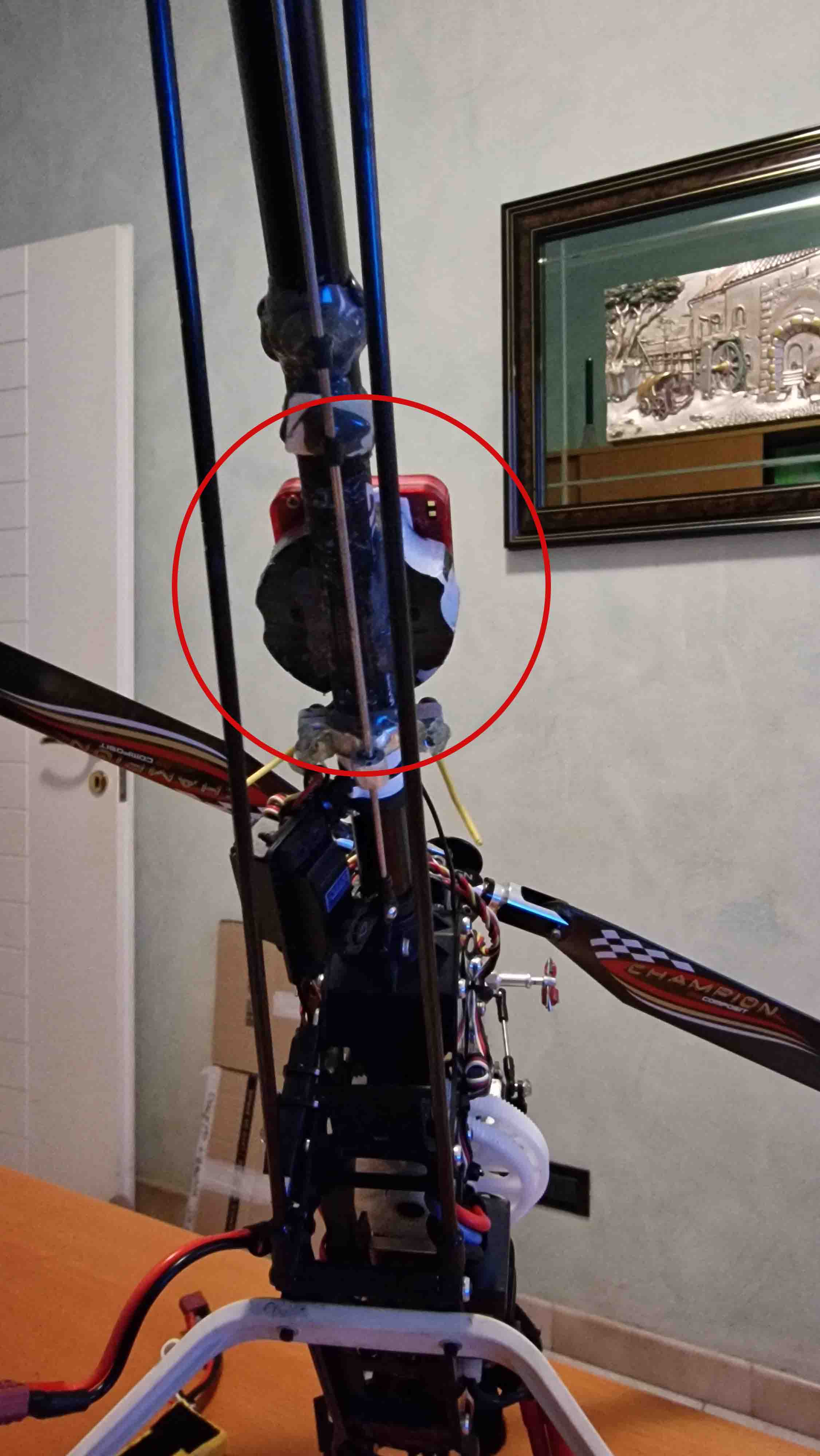

tomas I changed my head
I made sure that the laser has no obstacles
I did the setup from 0
I decreased the vibrations
now if i use 2500 rpm i have 40% vibration if i use 2600 rpm i have 60-70% vibration.
but I always get the same result
